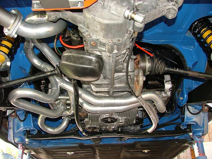

Does anybody have any experience with the OBX header? This is for a 2056. I need to redo the exhaust and while I would love a Tangerine setup its just not in the budget at the moment.

I mostly hang on the bird in the turbo forum, where heat is an issue and this brand has been discussed in turbo applications frequently. OBX I belive is a chinese mass produced product with questionable welds and fitment issues (at least for the 930). the problem with the welds is that there is typically a lot of slag left in these, just one small piece breaks off and your turbo is gone. The welds also crack fairly easily with the turbo heat as well, but as stated above, you get what you pay for. In a N/A 914 application, it may not be as much of an issue. People have posted pictures of the fittment being over 1/2 inch off at the heads...

I don't have that brand, but mine look the same. I can tell you that the 4-1 collector is just an exhaust leak X4. Had to weld mine up.

i was waiting for OBX to do the right thing before posting this but I have a duty to the 914 community to show ya'll this. OBX wants me to pay return shipping before I get a refund. I offered to help solve these incorrect alignment issues. I will post the email string that has been going on fro 6 months.

QUOTE(sean_v8_914 @ Jan 7 2011, 10:19 AM) *
if OXB does the right thing after seeing this I will still be surprised, but first the pics
Wow, thats not just off a little bit either.

I even sent these photos to OBX
obx sells on ebay under racing parts depot. they sell other porsche parts such as lsd limited slip
http://cgi.ebay.com/ebaymotors/OBX-HEADER-...sQ5fAccessories
they also sell OBX Helical LSD Differential LSD 92-95 PORSCHE 968 G50
I wonder if the quality control is the same crap as the header

That is just FUGLY
(IMG:style_emoticons/default/bs.gif)
I wonder how many exhaust studs have been broken by folks trying to "make it work" and squeeze them to fit? That one there has not chance of even hitting half the correct studs. Not even sure it those could be made to work with a chop and some "corrective" stub pipes.
Thanks for sharing this, it was the right call (IMG:style_emoticons/default/beerchug.gif)
