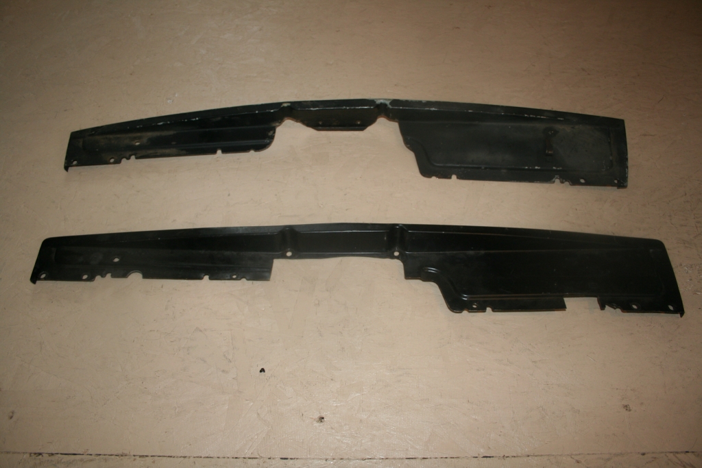

Question 1 - I have these 2 pieces. Both were supposed to be origional 914-6 sheet metal. They differ slightly, mainly in the center section. The length is the same, just looks different due to camera distortion. Whick one should I use?

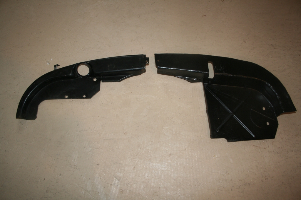

Question 2- I believe these pieces are not origional 914-6 sheet metal. I think they were made from 914 pieces and made to fit a six. Does anyone have these two pieces they are willing to sell? I'm looking for origional, not repro. Thanks, Mark

My factory six sheet metal from the rear...best pic I have...looks to me the lower sheet metal in your pic is the closest....mine comes apart in two pieces where the bolt is.....

The ones in your second post where they are two pieces looks right....and not the first two you posted....

I think your getting my questions confused. The first post is for the sheetmental at the back of the engine. I have 2 similar but not the same pieces and I want to know which one to use. 2nd post is a different question. Thanks. Mark

If you have a 72 or later -6 engine use the top long piece as the stock one will beed triming around the distributor.
Here is a post that has photos of all the factory pieces nos for reference.
http://www.914world.com/bbs2/index.php?s=&...st&p=594189
Question 2 Here a possible reason for it being not factory. For a long while that piece was NLA but the other pieces were available.
The other piece in the pic. is OG.

Also I think youre installing a 3.2 ?
You will have to cut that repo piece anyway to clear the head temp senor. why cut real stuff ?
