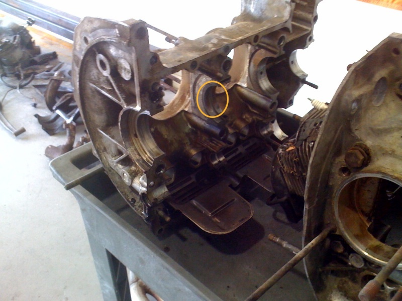

Center main and rod bearings. This engine was finished.
McMark
post Feb 19 2011, 12:30 PM
914 Freak!
Posts: 20,180
Joined: 13-March 03
From: Grand Rapids, MI
Member No.: 419
QUOTE(Series9 @ Feb 18 2011, 06:33 PM) *
QUOTE(McMark @ Feb 18 2011, 04:14 PM) *
Whoa! That's a beat up main bearing. Might have a lead on a good 1.8 if you're interested.
Mark,
All the bearings look pretty rough, but not compared to the cam and lifters. When the flashlight illuminated the cam, the disassembly was on.
You build a lot more of these than I. Show me the detail in the photo which made you make the comment about the main bearing.
You can see the copper colored wear marks clearly here. Bearings shouldn't be wearing down that much. There's a good chance that case needs a line bore as well.
sean_v8_914
post Feb 19 2011, 12:47 PM
Chingon 601
Posts: 4,011
Joined: 1-February 05
From: San Diego
Member No.: 3,541
out of balance, crank flex, had a wobble? why else would the wear be left to right?
