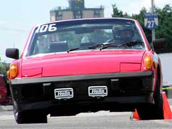

As I recall the brackets were attached to the bumper on 914.043.0691.
I would mount the Oscars to the front bulkhead of the car.

Adding lights very much improved night driving. But you need to remember to run a relay in line, and you have to be careful of aim. They are low and can reflect a lot of light back up in the eyes of oncoming traffic if improperly aimed.

Another thing you need to remember is that the benefits of powerful driving lights are severely diminished by mounting them low. Along with this, the side effect of blinding oncoming drivers is increased. True rally cars have the lights mounted as high as is feasible. While these aren't "fog lights" (which should be mounted as low as possible), they share the side effect of actually decreasing your ability to see at a distance because the foreground is flooded with bright light. Don't take my word for it, do a little research on your own.

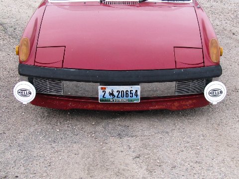

Do a search on the lights from user Aaron Cox. He had some mounts made (or maybe bought from Rennenmetal?)
Yup, like this. Eric called it right, Rennenmetal.com

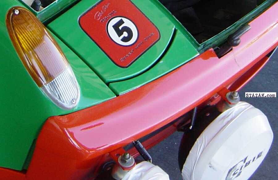

Here are the brackets on a friends real GT.. This is what I want to do for my clone..
These are the lights I am using on my car..
