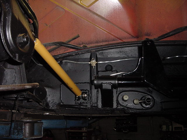

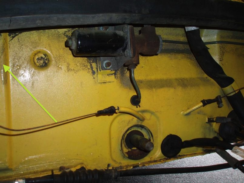

70-74 cars have the P-valve mounted on this rib.

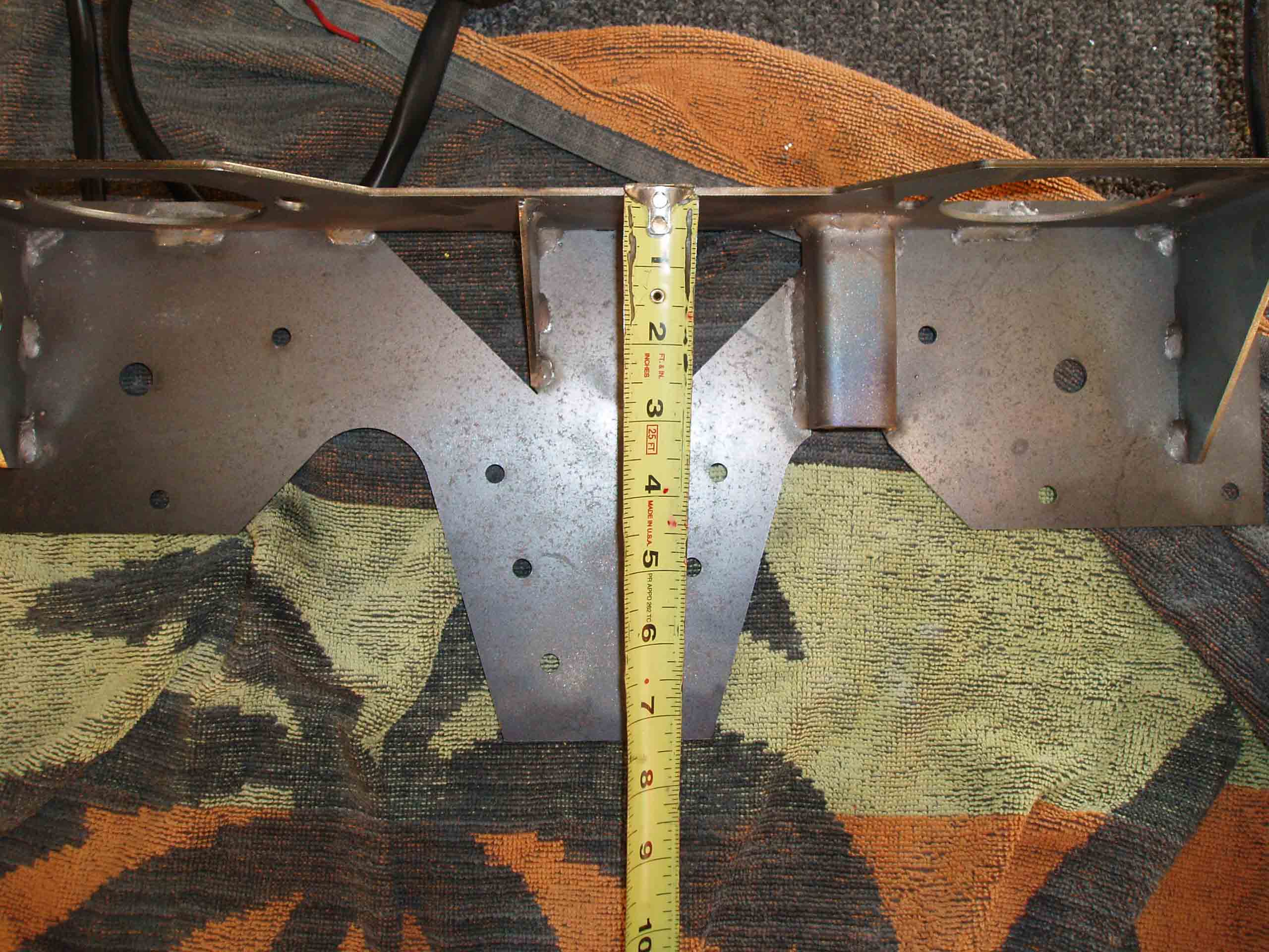

7" would put the lower part of the mount below the lower body seam!?? It is a CIS motor but I am modifing the injection to fit without cutting or lowering!
I read the coments about the rear brakes locking up and I may have to join you in death (IMG:style_emoticons/default/happy11.gif) unless someone else has any other ideas! I will be upgrading to larger fronts later but not right away!
Here is a photo with the tape messure!

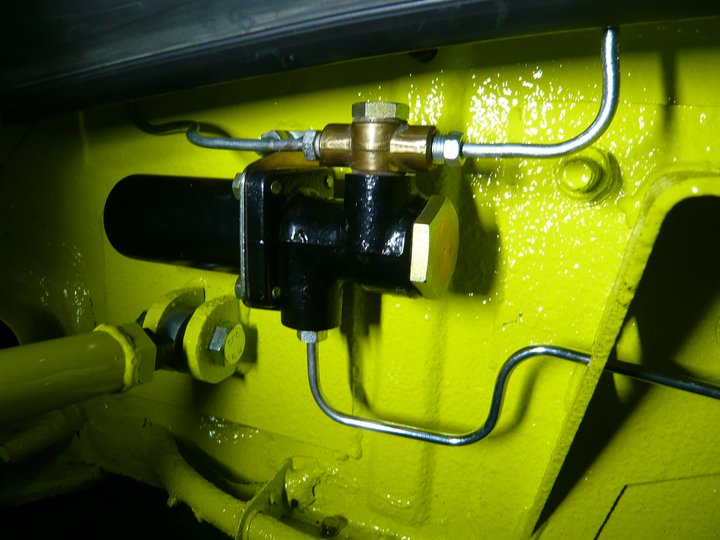

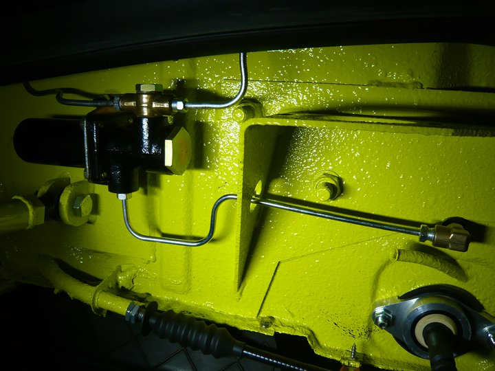

I'm doing this too. Eric sent me these for placement of the regulator. You'll need an early regulator or valve and the hardlines.

That's what a grinder is for. I cut that "tab" so that the bottom rested on the seam and welded it in. I also welded all around the mount ... no bolts ... just welds.
Unless he modified the mount, you may have to open up the cutout for the main loom gooseneck to go through. I had to on a '70 conversion ... didn't have to on the '74 conversion.

Get an early style "PRESSURE REGULATOR" (it's not a proportioning valve as it doesn't proportion anything) and get the early lines too. Do not follow my picture, do what McMark says and mount it on that rib. Here's how:
1. Mock install the lines. There are two clips that should be on the firewall, one for each side. These (if they're still there) should help hold the lines in place.
2. Hold the pressure regulator up to where the lines would meet it and mark the loaction on that rib.
3. While you are in there welding the motor mount in, weld two 8x1.25x20 fasteners on that rib in the proper location (take said valve under there with you to ensure they are in the proper location.
Then sit back... have a (IMG:style_emoticons/default/beer.gif) and revel in the fact that you did it right. (IMG:style_emoticons/default/wink.gif)
The switch was made in 74 so... a lot of 74 cars have the late model location.
