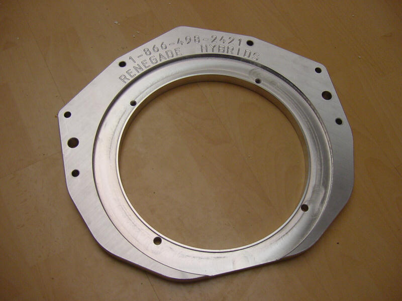

Renegade billet adapter...

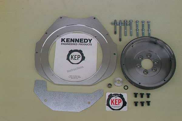

KEP adapter...They tell me they supply to Rod Simpson.
