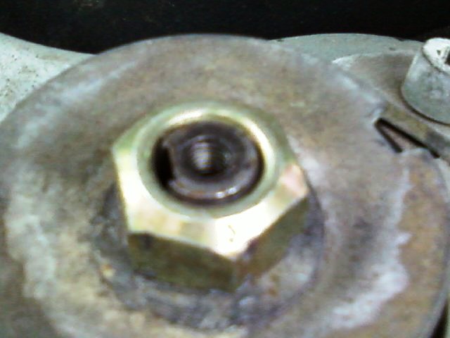

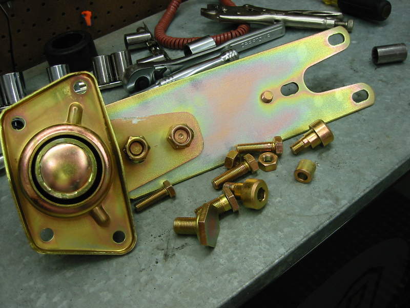

Here's a quote from the FAQ and information about Zinc plating, cad plating
"Without a special laboratory analysis it can be very difficult to nearly impossible to tell the difference between the two."
Here are pictures of Yellow Zinc plating.
From Yellow Zinc plating.com
From Zinc Yellow Plating

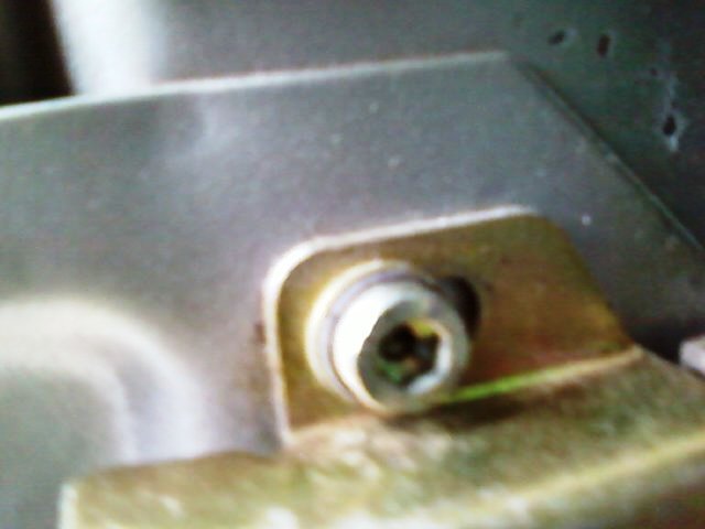

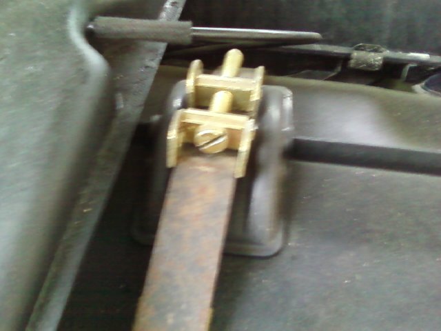

Here are pictures of Cadmium plating.
From Cad questions
From the Bird thread Cad plate look
