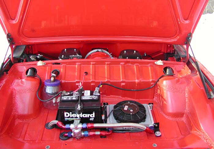

I put the battery in the rear trunk not because of rust, but was a nice place to put my MSD unit. Also freed up a lot of space in the engine compartment. My battery tray was a real bitch to cut out. (IMG:style_emoticons/default/smash.gif) (IMG:style_emoticons/default/smash.gif)
Oh and I also have an Oil cooler back there (IMG:style_emoticons/default/wink.gif)

Here ya go

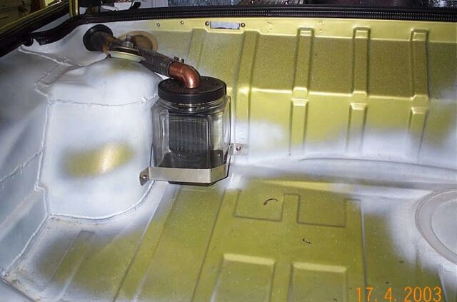

J P Stein

Hay, Joe, nice catch can. What was it in its previous life?

QUOTE(J P Stein @ Apr 17 2003, 09:29 PM)
It was a mayo jar .... (IMG:style_emoticons/default/biggrin.gif)

I finally tied down my mixed nuts jar

Thanks to all for the valued opinions. I really appreciate the info. What's the catch can mayo jar for anyway??
Cheers, Elliot

QUOTE(nealnorlack @ Apr 17 2003, 07:05 PM)
Cheers, Elliot
Those elitists have 914/6's. Its to catch oil, why I have no idea..

QUOTE(ChrisReale @ Apr 17 2003, 07:06 PM)
Hay, that's "elitist pigs".....anyhow, oils a comming out if you're workin' the motor....that's something else we eliteist pigs do. If you don't catch it, it makes a hell of a mess. I've pumped out as much as 6 oz (WAG) at an AX session.
