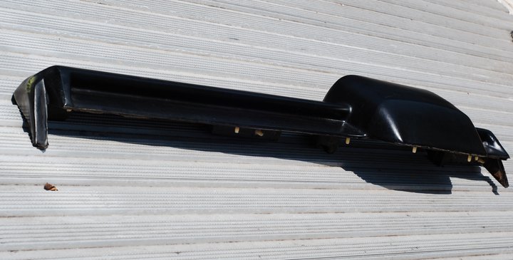

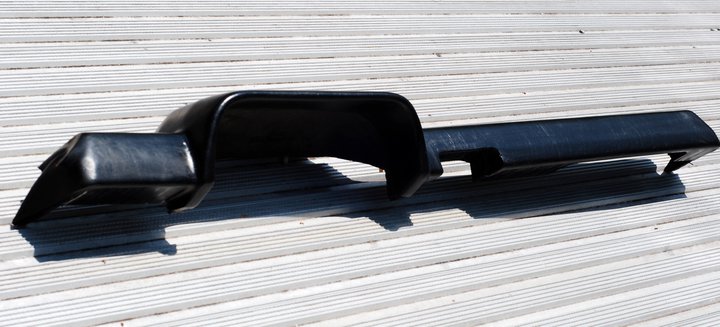

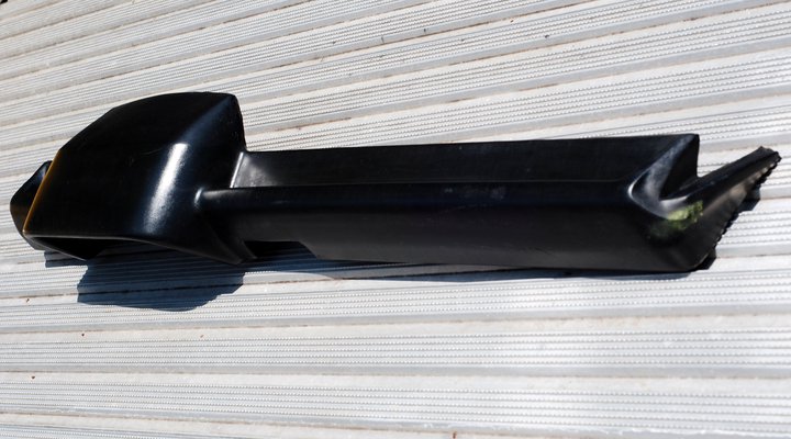

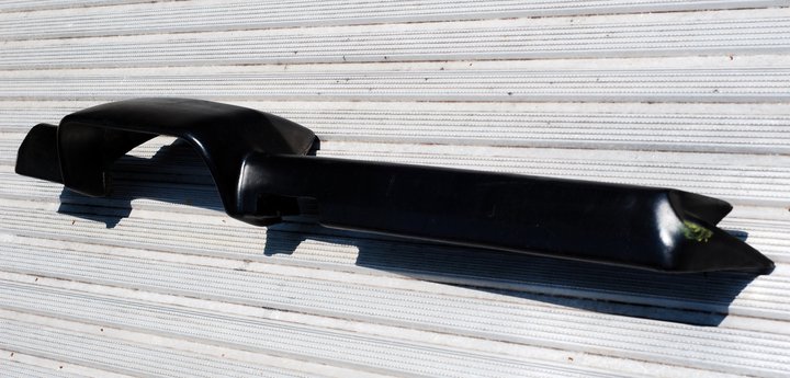

How about some pix to compare the differences..

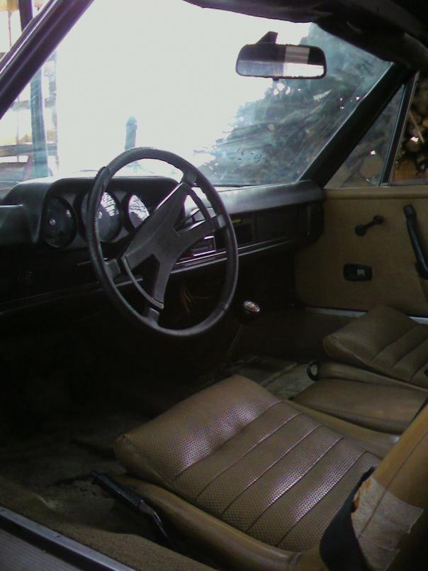

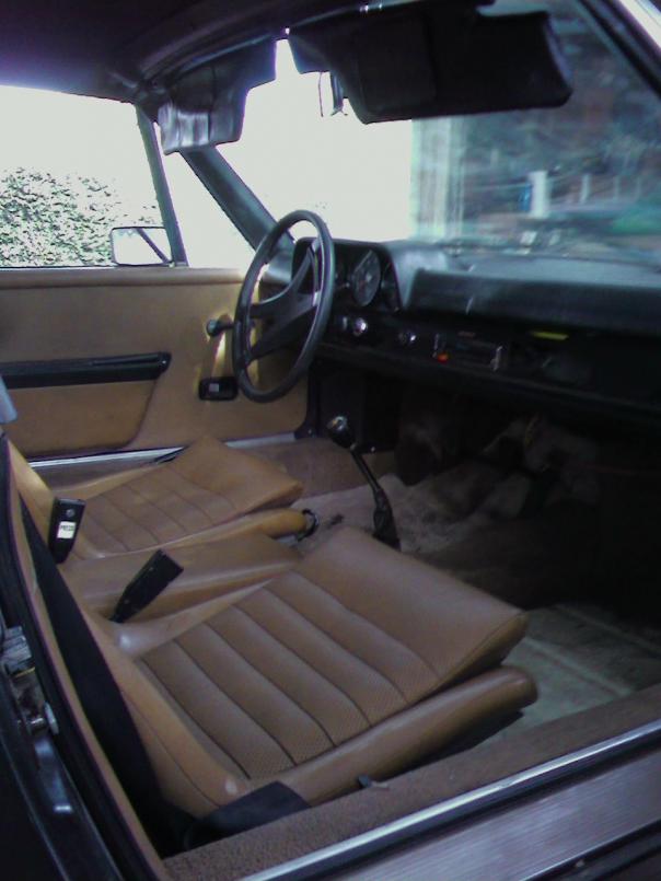

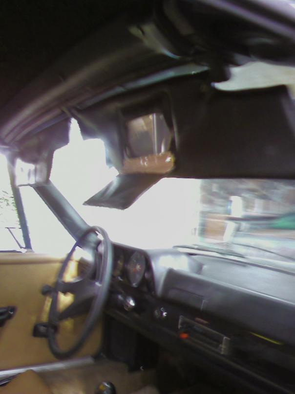

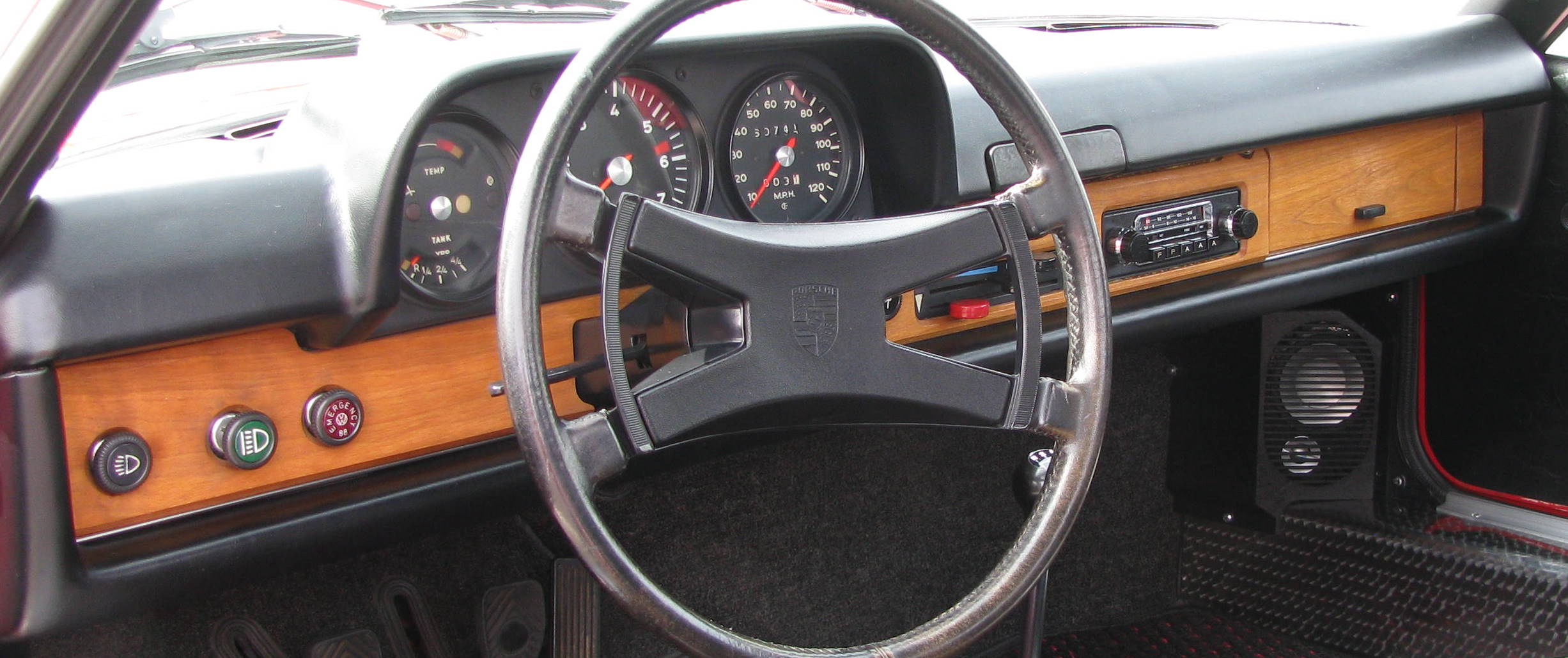

Byron - the big difference was adding fresh air vents at each end, with corresponding shortening of the glovebox/door & shifting inboard of the switches on the far left. So the top & knee pads differ accordingly.
Here's my buddy's 71 914/4 (that's a dealer supplied rosewood dash face option since sold new) without the side vents -
... continued next post ....
Tom_T
post May 12 2011, 12:47 PM
TMI....
Posts: 8,321
Joined: 19-March 09
From: Orange, CA
Member No.: 10,181

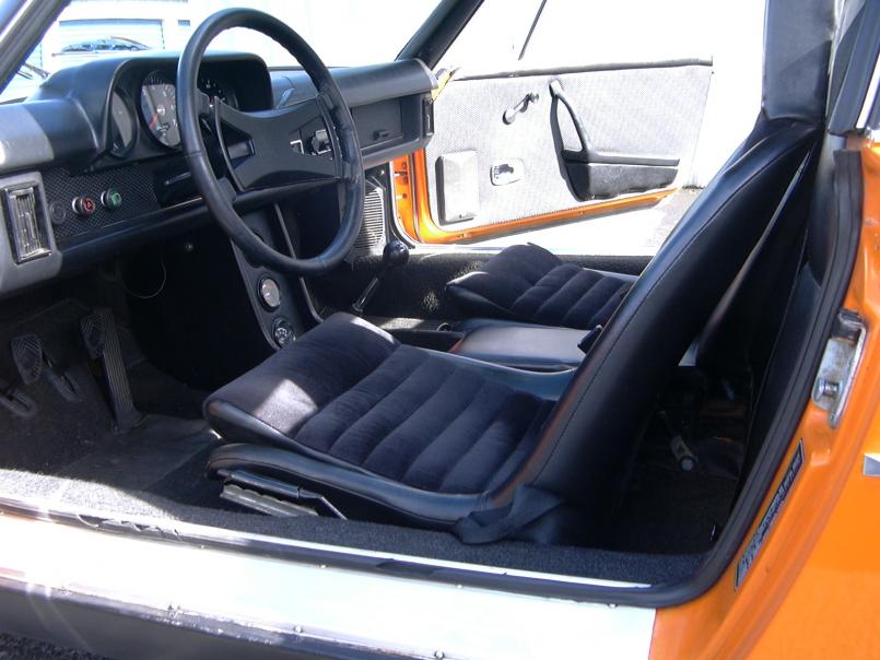

.... and .....

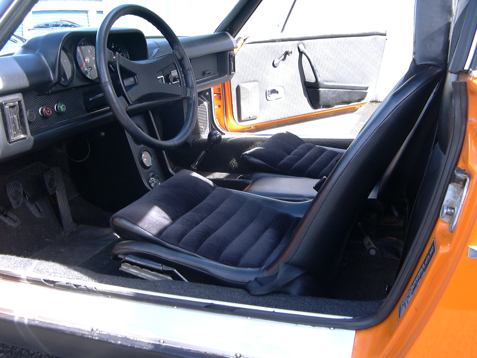

Here's the dash on my 73 2.0 with the late style side vents (radio is out, so that's the hole to left of glovebox) -
... (sorry for the dark & fuzzy cellphone pix)
Hope this answers whatever you're looking for! (IMG:style_emoticons/default/beerchug.gif)

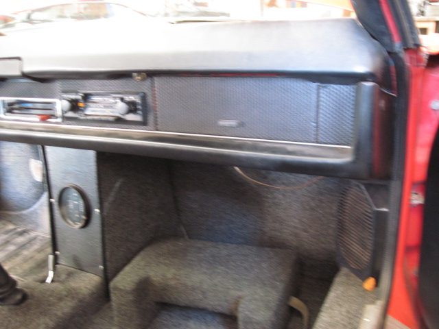

Here's a better pic of the left/driver's side of the dash from another 73 2.0 -

Best way to tell is mesaure the width of the indent where the glove box is. Longer indent is early (bigger glove box) sjorter is later. You can use the later one on a early car, but glove box lid wont open all the way up.
racerbvd
post May 13 2011, 08:53 AM
Posts: 2,381
Joined: 3-February 03
From: Sunny FL.
Member No.: 226
QUOTE(Garold Shaffer @ May 13 2011, 03:28 AM) *
Thanks Garaold, the 2 dashes I have handy (I have a few core ones in storage) measure 13" at the widest (back of the glove box opening) point so I'm guessing this is late..

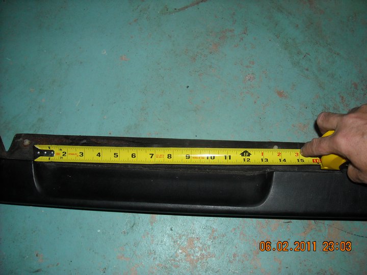

I measured mine. I'm lucky they're both late. (IMG:style_emoticons/default/smile.gif) The clearance for the glove box opening measures 12.5 inches at the back (front) were it would touch the dash. The part above the vent measures 4 inches.
racerbvd
post Jun 2 2011, 06:57 PM
Posts: 2,381
From: Sunny FL.
Member No.: 226
Thanks, so 13.5 across in the glove box area makes it correct for a 70 & 71?/
GaroldShaffer
post Jun 2 2011, 07:54 PM
You bought another 914?
Posts: 7,664
Joined: 27-June 03
From: Portage, IN
Member No.: 865
I would say yes.
racerbvd
post Jun 2 2011, 09:09 PM
Posts: 2,381
From: Sunny FL.
Member No.: 226

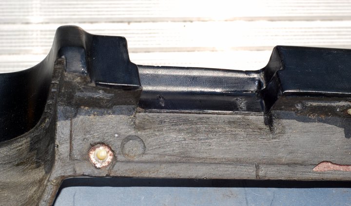

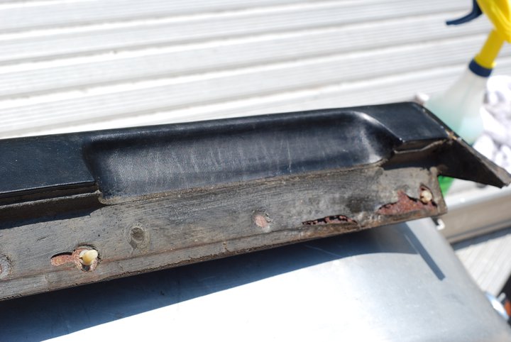

So this is correct then...
