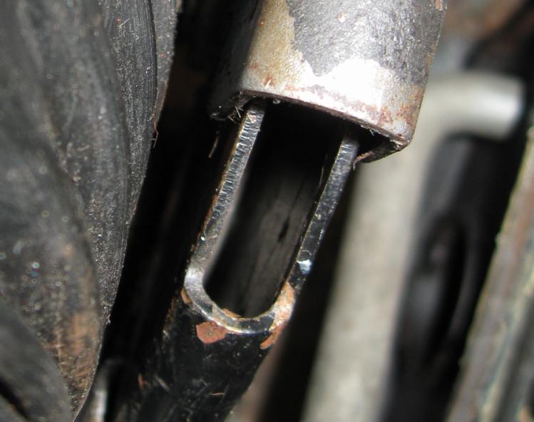

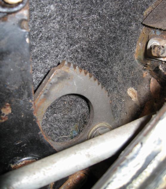

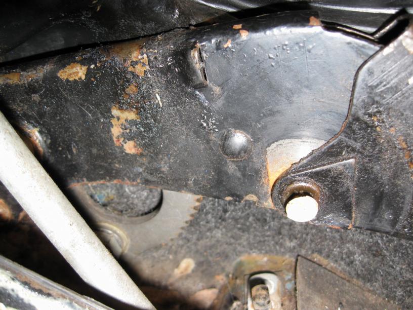

I pulled my seat and took a few pictures. Full up:
full down:
and a shot from the top showing the pawl hiding in there:
I wiggled things around a bit and can get the back piece of the lever to rotate (needs a little grease or wd-40), but the pawl never engages the teeth of the stationary gear. It seems that at some point I (or a DPO) pulled it up too far and completely disengaged the pawl from the gear.
Any ideas from here?
Thx,
S

Oh, that's a good data point. Your cables are way too loose if you can pull the lever up that far with the cables still connected.
Can you push the button in all the way to disengage the pawl and then move the handle down?
(A) If yes, do that, adjust vent clearance, and adjust the locking nuts.
If no, then dis-assemble the e-brake handle, get it working and then goto (A)
(IMG:style_emoticons/default/aktion035.gif)
