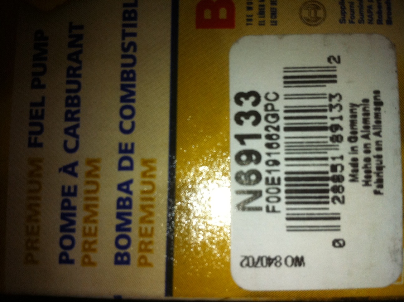

I'd like to know your opinion after you take a look (worth permanent install?).
Here's a photo of the NAPA code # and country of origin: Deutschland.
TheCabinetmaker

SLITS
post Jun 16 2011, 04:25 PM
"This Utah shit is HARSH!"
Posts: 13,602
Joined: 22-February 04
From: SoCal Mountains ...
Member No.: 1,696
QUOTE(Prospectfarms @ Jun 16 2011, 11:17 AM) *
I would install it with a smile and motor on. It should be a good piece that used to sell for $175+ dollars.
