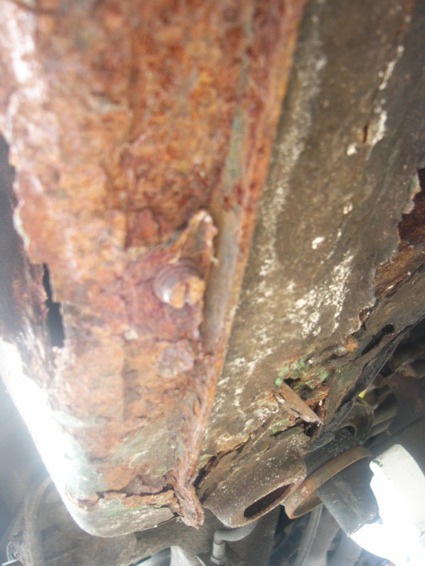

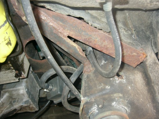

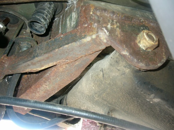

About a year ago I seen a 914 sitting on the corner for sale and it was like love at first sight.So I ran to the bank as fast as i could, pulled out 2000 smackers,and bought the car before anybody else could buy it (IMG:style_emoticons/default/wacko.gif)
Well a few months later I found this website called 914world.com,an noticed lots of people talking about rust in the battery tray area, so I went outside and took a look at my own car....Holy F*&%in shit my car was rusted all the way through to the suspension (IMG:style_emoticons/default/headbang.gif) (IMG:style_emoticons/default/headbang.gif) .........It looks like the right trailing arm mount busted at sometime or another, because the PO (IMG:style_emoticons/default/finger.gif) welded some 1/4 in steel to hold it together....
I started to look a little farther and found rust everywhere,the longs,under pass seat,everywhere.........I guess my question is would this be worth fixing myself or would it be cheaper to buy a rust free tub? Here are some pics..............

The most economical course of action would be to buy a whole other car rather than just a tub. I say that because straightening and painting a tub is expensive and moving everything over is time consuming. Buy a nice 914 and then part this one out. You'll probably get more than your $2K back if the rest of your car is nice and you'll have a ton of spare parts that you'll need.

wow... that's nasty!
If you like messing about and/or do a full resto, get another tub
If not, get another decent teener and part this one out. Hopefully, the parts will cover the cost of the car, so it won't be an expensive lesson.
Either way, don't bother fixing this one...

nasty nasty nasty.....
i suggest you get a new roller transfer everything or get another car and part this one out.
btw you get youre fuel pump problem fixed.is the car sagging yet ? i realize youre prob on a buget you can weld in more scab support and drive it for a year or two untill you can find a replace ment car or tub.

I'd buy another whole car and treat this one as a parts car. Once you've stripped it of everything you want to keep to maintain the new one, sell the rest for whatever you can get for it.

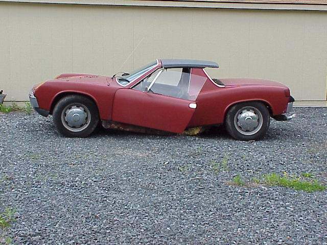

Yup I got the fuel pump problem fixed, it was a relay. It's sagging a little bit but not much. The car has alot of nice parts,so i'm sure once I find a good roller i'll have myself a nice car...........But untill then I guess i'll drive her till she splits (IMG:style_emoticons/default/biggrin.gif)

I would start looking now though, we dont want to see you next post with this picture in it.

The bracing the guy put on the suspension ear looked O.K. to me in that single photo... might be stiffer than the original if he did it right, although he could have at least cleaned it up and painted over it instead of letting it rust again. Other photos show need for some major rust repair.
