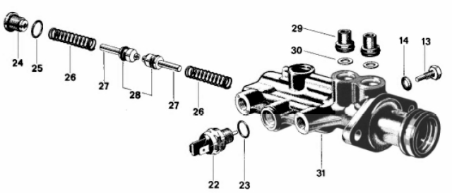

First off, I would recommend a flashlight. (IMG:style_emoticons/default/biggrin.gif)
Anyway, the button is hidden under a rubber boot. In the crappy picture below, the rubber boot is #25 and the button (warning switch) is #23. You can press down on the rubber boot to reset the switch.
Oh, welcome to the club. (IMG:style_emoticons/default/clap56.gif) (IMG:style_emoticons/default/clap56.gif) (IMG:style_emoticons/default/clap56.gif)

Here's a better crappy picture. Number 22 in this pic.

A flashlight? (slapping forehead)...Of course...that's it!
Thanks for the pics guys...Yea, I found that switch. Thats how I removed the wire...but there is no button to push...Maybe I will re-investigate.
