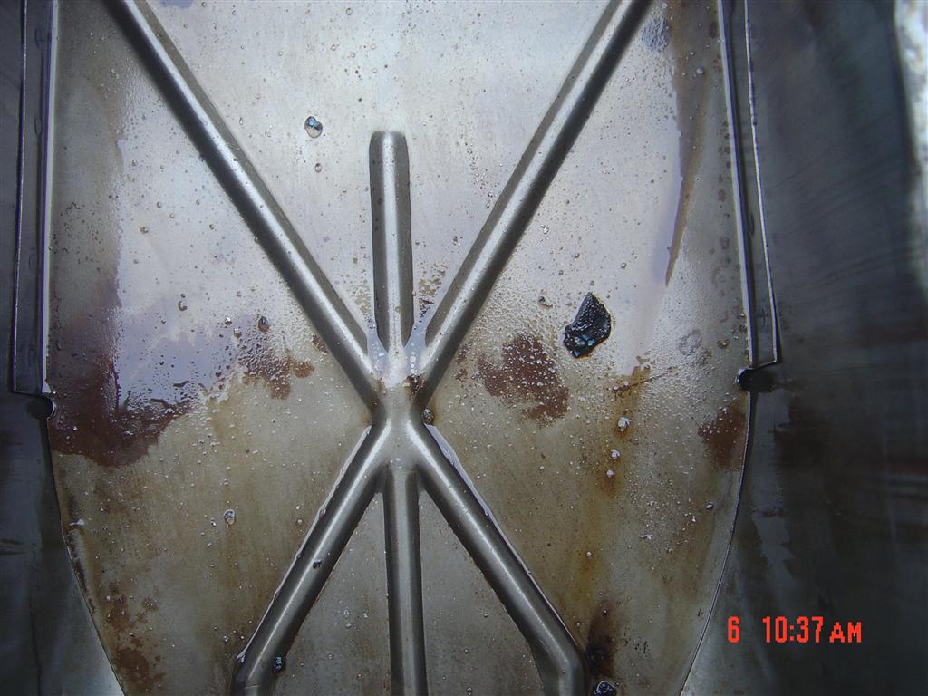

I felt compelled to post these pics and do a little admonishing.
First off let me make it clear that while this is Jim's engine this is NOT Jims handiwork. He bought this engine as is and had no idea of the " work, previously pervormed.
Whoever put this intake manifold on not only liked RTV, but also felt it was needed in some VERY unnecessary areas. First off there is NO need to put RTV on an intake manifold gasket. The blue seam in the center of the gasket is a crush ring. When the bolts are torqued down, the blue insert crushes and spreads out to form the seal. Hence NO NEED FOR RTV. Looking at the water jacket you can see how the RTV goozed out into the water jacket thus closing a fair portion of it off. Now this alone is not all that detremental as the coolant will still flow, BUT what would happen if this chunk managed to break off and start flowing through the passages ? The worst spot is at the ends of the manifold. It IS common practice to use a bead of RTV in these areas as the " factory style " rubber strips are notorious for slipping upon torquing the bolts down and end up leaking. This engine however, once again had too much RTV applied and you can see the dingleberry hagning down just waiting to break loose into the intake valley. Nexzt stop is the oilong passages. NOT GOOD. This is certainly not the first time I have seen this and I am sure it will not be the last. (IMG:style_emoticons/default/sad.gif) Please be careful with your RTV usage

RTV on gaskets should be applied microscopic thin! Tiny dot on the finger and spread it around to a thin thin film.. If you think you dont have enough, you have to much.

Guess what that tells me? Yep... An idiot was there. What else is there that you can't see?

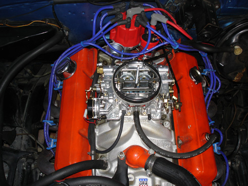

jimkelly
post Sep 5 2011, 08:45 PM
Delaware USA
Posts: 4,969
Joined: 5-August 04
From: Delaware, USA
Member No.: 2,460
here is a pic of the engine when it was still in a 1969 camaro convertible 4 spd.

I had a simliar problem with my manifold. One of my water jackets was completely plugged off. The other was about half covered. It was no wonder I was having cooling issues at the time. Amazing how when I got all the RTV out of there. MY cooling problems went away too (IMG:style_emoticons/default/idea.gif)

btdt - used to own a '71 240z that developed a loud squeak / squack sound at about cam lobe frequency. when i removed the valve cover, one of the lobes was dry. turned out a little glob of gasket sealer had broken off somewhere and found it's way into the oil feeding the cam lobes plugging up a little feed hole...
pieces much smaller than the gobs in scotty's pics will plug holes!

There was 1/4 inch of RTV used to seal my intake when I tore down the 350 for my truck. I found boogers like above all over that motor.
Zach

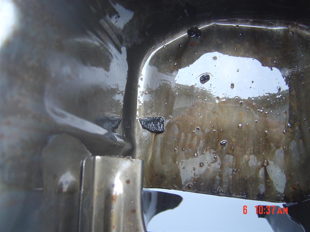

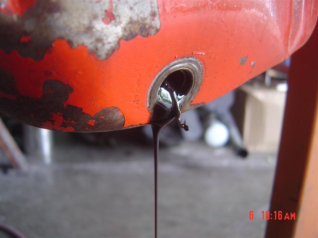

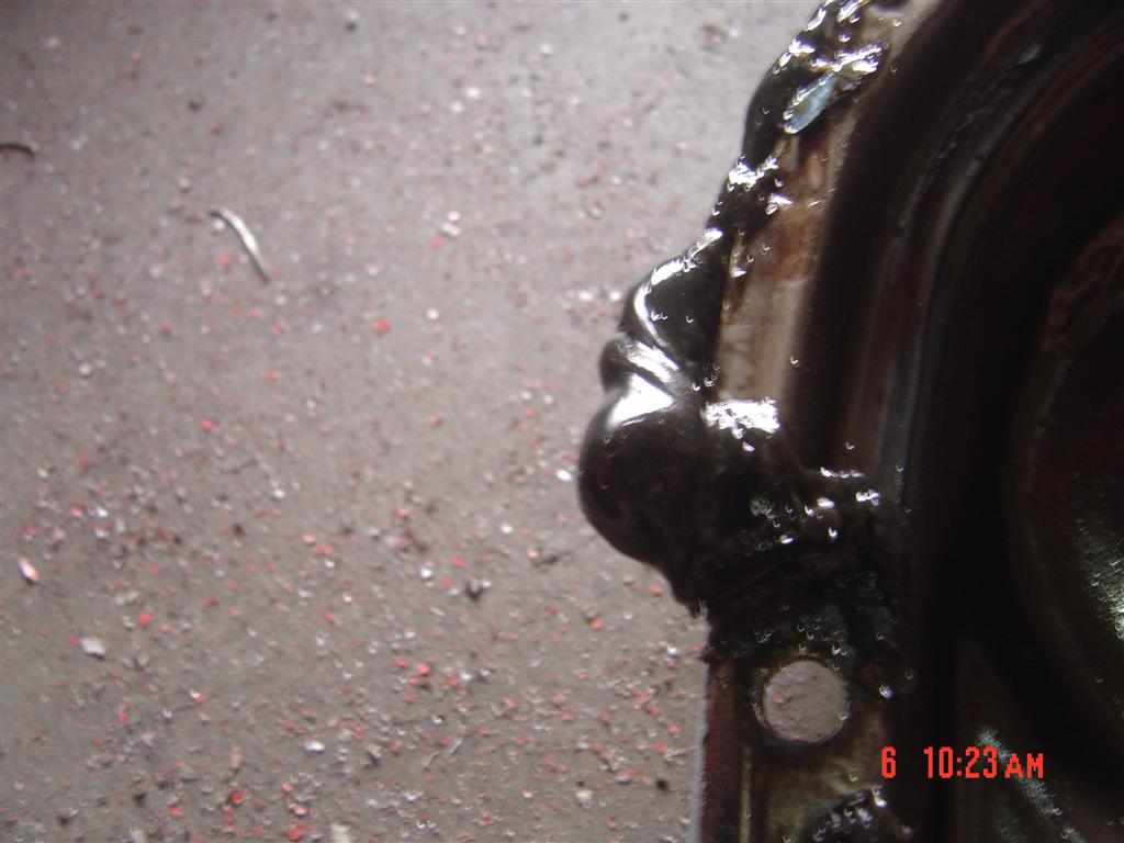

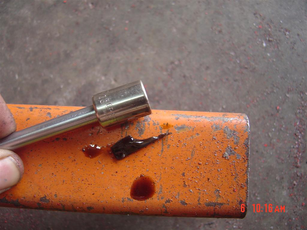

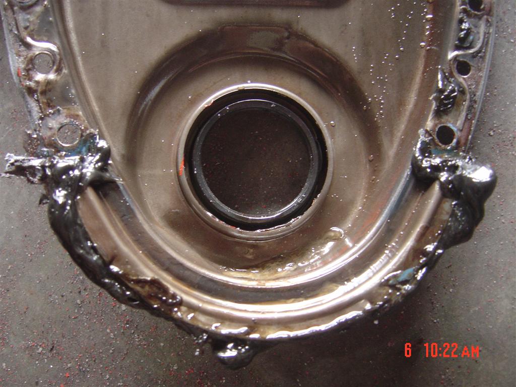

scotty b
post Sep 6 2011, 11:10 AM
rust free you say ?
Posts: 16,375
Joined: 7-January 05
From: richmond, Va.
Member No.: 3,419

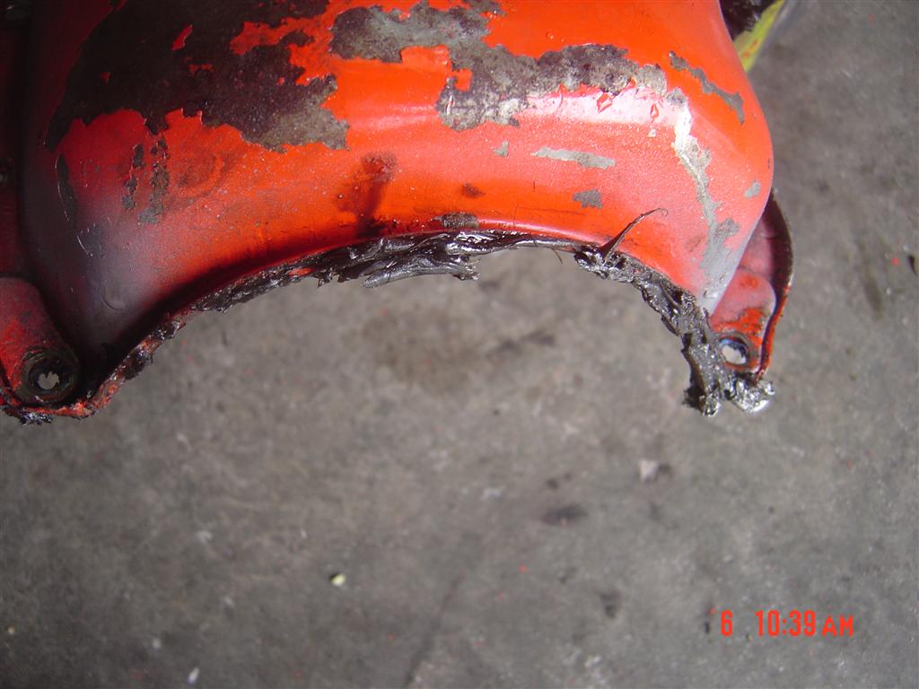

So today I gave the block and heads a quicl wire brushing to remove the loose paint and hit some of the crudier spots relaly well. then proceeded to paint the engine. Once the painting was done I removed the valve covers, t.c. cover and oil pan. Guess what I found (IMG:style_emoticons/default/dry.gif)
