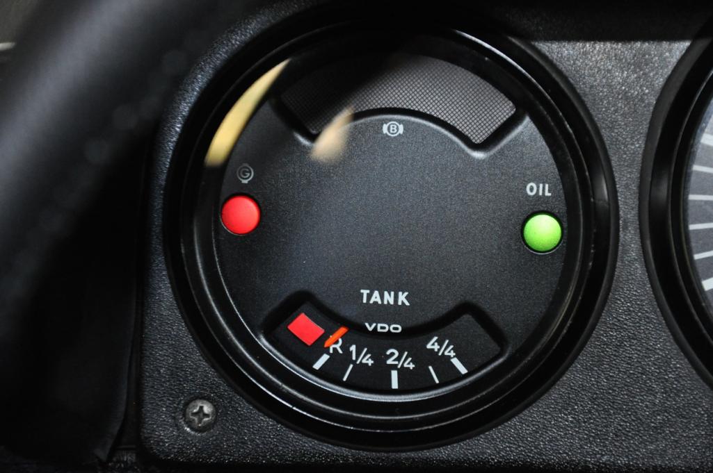

I pulled my fuel gauge/warning light/oil/alt belt gauge today to clean the lens on my 75 1.8. Interesting that this gauge and the speedo are both glass but the center tach is plastic (must have been using up stock at the factory).
Anyway I read somewhere about someone trying to figure out what to replace the red plastic piece with that is used to indicate low fuel. Mine like others had faded and looked really bad.
I had a dark red spray paint cap from repainting my heater control knob. I cut out a piece and then cut it to the right shape and flattened it and taped it in place. The color looks good with a light shining through it, with plenty of light, but looks red, not pink.
Thought I would post this in case others ever want to replace-it was very easy to do.

I think that was me posting about the replacement piece for the gas gauge. I used a couple of pieces of red plastic from the tabs of a 'hanging folder'. It looks good, but I did shine a flashlight from behind it (like the light would be) and it was definitely pink. I'm sure the flashlight was brighter than the actual bulbs in our car, but I'm betting ti would still be pink. GREAT idea on using the red spray paint can top. I can see how that would be about the same thickness as the original part.

Finally, A picture of the paint can plastic cap I used to replace the low fuel light marker that had faded. The ignition is in the "on" position, and the car was truly low on fuel, so the low fuel light is glowing through the newly replaced plastic marker:
Rob-O
post Nov 17 2011, 09:07 PM
Posts: 1,310
Joined: 5-December 03
From: Mansfield, TX
Member No.: 1,419
Very nice! I may have to change mine. That red is bright, I may have to find something a little darker. By the way, I worked in the paint and plastics industry for about 25 years. Specifically in the weathering characteristics of materials. Red is probably the toughest color to get to last. Easiest? Black.
