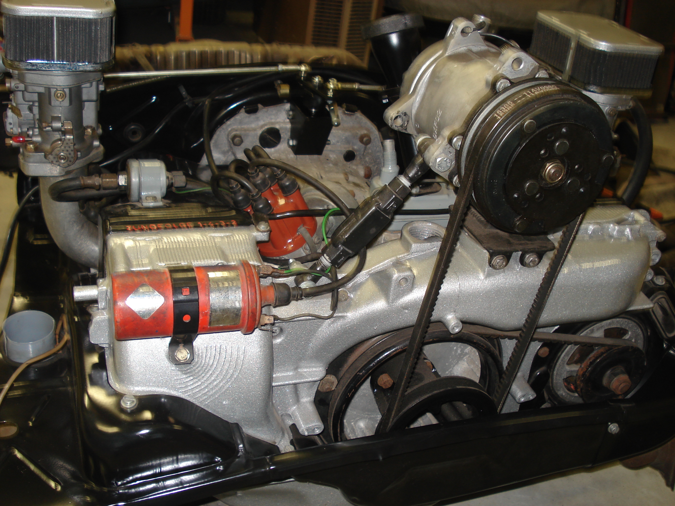

Use a pulley like the one I am using on my A/C setup. I believer they were for bus / type 4 engines.

QUOTE(zambezi @ Sep 25 2011, 08:57 PM) *
Problem solved. Nice setup.
