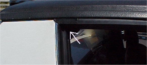

Trekkor
post Jul 20 2004, 05:49 PM
I do things...
Posts: 7,809
Joined: 2-December 03
From: Napa, Ca
Member No.: 1,413
here.
Make sure the trailing edge is as far foward to allow proper seating of the top.
KT Wills

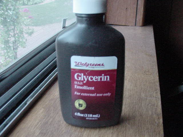

rhodyguy
post Jul 20 2004, 08:21 PM
Posts: 22,249
Joined: 2-March 03
From: Orion's Bell. The BELL!
Member No.: 378
go to walgreens, riteaid, longs,.. and get a bottle of this. works great for widow squeegees too.
kevin
