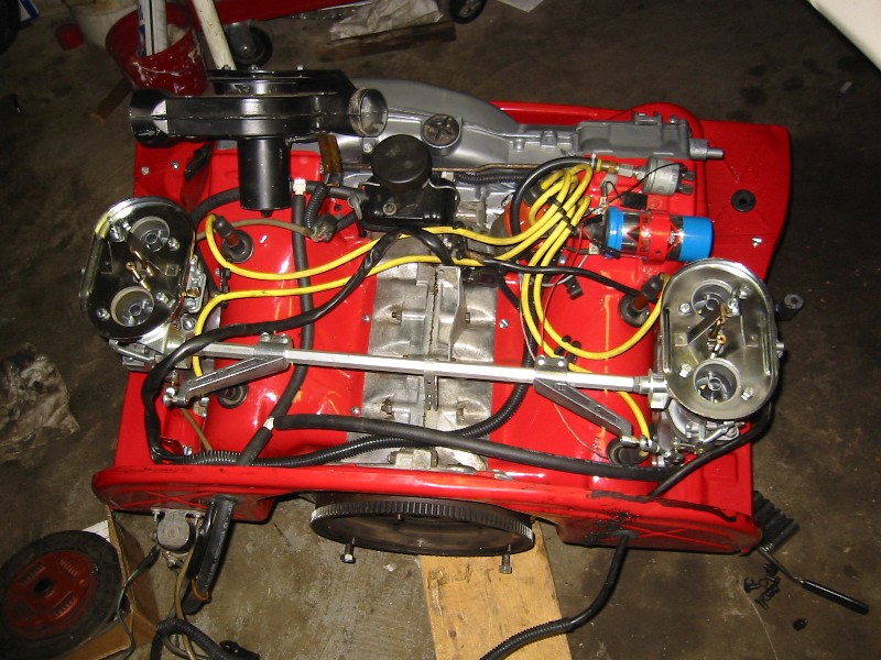

Here are a couple of pictures that may help you out.

I have a very similar linkage as shown in the pictures,
I don't like the angle of the short linkage...I am thinking about fliping the ball socket up rather than down. This should make the linkage that moves the throttle plates more straight up and down..herb

for starters place the linkage setup on the front(fan side) of the engine. this will make it easier to adjust the threaded rods when you get the carbs to flow evenly. do not plan on using the stock fuel pump for the fuel injection. i would recommend not using a facet pump. find a rotary pump regulated for the correct fuel pressure. cb offers a nice one. blow out the circuits, canned air works well. i hope that the venturis are the correct size for the application for the displacement of your engine. andy's carb thread was interesting, especially his venturi size. get thomlinson's book, again from cb performance.

after seeing your picture post... if it runs well leave the fi on the car. check all of the fuel lines. if they look deteriorated get the correctly sized high presure fuel line and the correct clamps.
