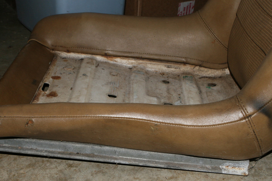

I stand corrected... The rear 'seam' has an angle to it. Here you can see my 914 happens to have two driver's side seats in it.

McMark's pictures show the difference - the line at the bottom of the headrest is meant to slope with the firewall
