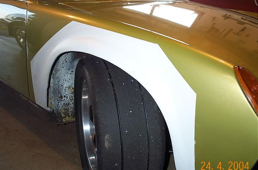

I run 225 X 45 X 15 on 7 inch wheels.....22.75 inch tire dia.
My clearance problems were at the top of the fender well.
I hammered out these tacky flares and moved the lip up 3/4 inch.
