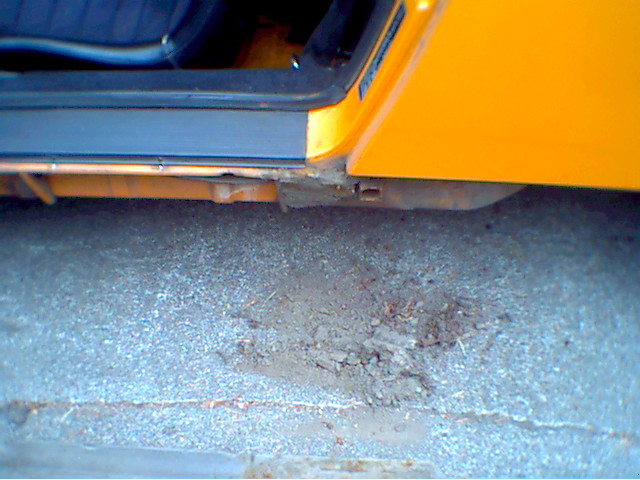

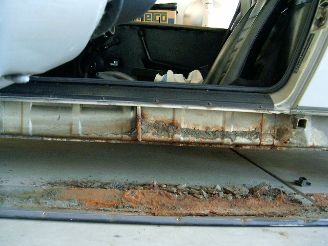

Got my rocker panel back from a body repair guy today. Started the swap and wanted to post a few pictures of the process and of what I found lurking under the old one (IMG:style_emoticons/default/smash.gif)

Another with the panel off.

A little closer of the rust. Not too bad I think.

Found one small hole that I can weld up. Will POR-15 after a good cleaning with a wire brush and drill work on this?

Last one. I will add more when done.

Looks like you caught it just in time!

Yeah, I think you caught this in time to make it a quick fix. I used POR15 for the first time this week. Seems like great stuff! Only the test of time will tell.
Check this out, not as much as what you had, but still, look at all the dirt packed up there!
