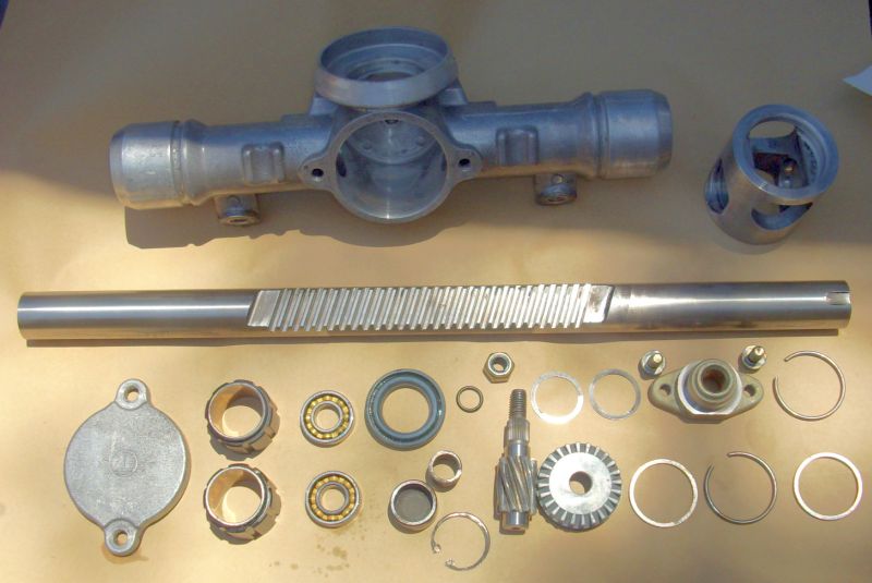

No real trick to doing it yourself. . I did mine when I put on the Turbo tie rods. . . nice to get fresh clean grease in it. . .
there are some adjustments and shims so take it apart carefully. . Took about 3 hours and 2 beers. . .
OmaPossu
post Nov 25 2011, 04:37 PM
Posts: 241
Joined: 4-October 09
From: Finland
Member No.: 10,886
Okay, that's how it looks inside. Lets see if mine looks similar (IMG:style_emoticons/default/wink.gif)
