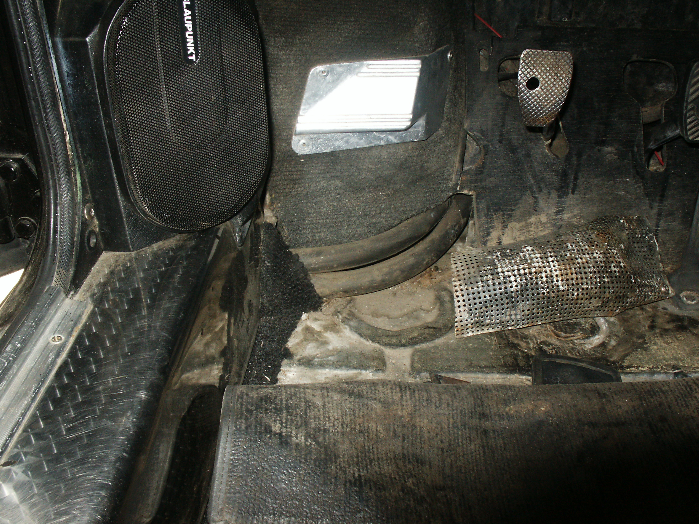

If i had to do it again, i'd run them outside and cut through the front portion of the long (make a nice box) and run them through the channel under the gas tank.
That way, you can keep the heater mufflers if you ever need them plus the oil gets more cooling running on the outside.
Whatever you do, don't run them on the inside. Because if you do, your GF will kill you after your first roadtrip.

Nope. I'll be running the lines along the outside of the long, under the rocker covers and then go inside the passenger cabin right before the end of the long.
The lines will exit the long on the inside under the outlet for the heater tube, run along the inside of the fender well and into the same channel under the tank i'm using right now.
That way, the lines will only be exposed on the inside for about 12" or so.
(IMG:http://www.914world.com/bbs2/uploads/post-179-1180675993.jpg)
Plus, the lines are not exposed to the wheels in the fender well ...
