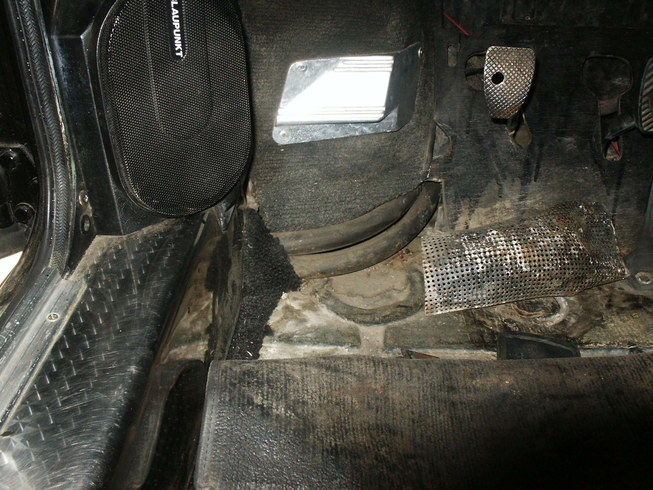

I ran my oil cooler lines under my outer rocker panel. I have a hole in the lower left side firewall, in the front they go through the existing opening in the front fender well.

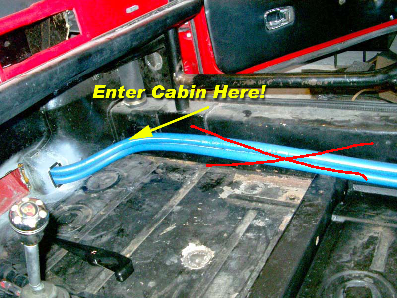

Nope. I'll be running the lines along the outside of the long, under the rocker covers and then go inside the passenger cabin right before the end of the long.
The lines will exit the long on the inside under the outlet for the heater tube, run along the inside of the fender well and into the same channel under the tank i'm using right now.
That way, the lines will only be exposed on the inside for about 12" or so.
IPB Image
Plus, the lines are not exposed to the wheels in the fender well ...
