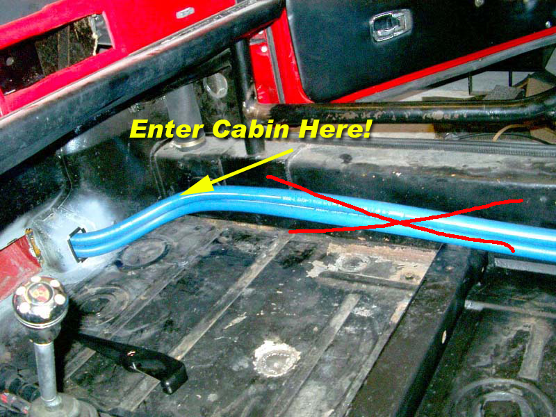

post Nov 15 2011, 10:03 PM
Resident German
Posts: 42,479
Joined: 21-January 03
From: Oakland, Kalifornia
Member No.: 179
QUOTE(Krieger @ Nov 15 2011, 07:06 PM) *
Andy, I'm not sure of your future routing you described. Would they go into the front fender? Is that where you'd build a box?
Nope. I'll be running the lines along the outside of the long, under the rocker covers and then go inside the passenger cabin right before the end of the long.
The lines will exit the long on the inside under the outlet for the heater tube, run along the inside of the fender well and into the same channel under the tank i'm using right now.
That way, the lines will only be exposed on the inside for about 12" or so.
(IMG:http://www.914world.com/bbs2/uploads/post-179-1180675993.jpg)
Plus, the lines are not exposed to the wheels in the fender well ...

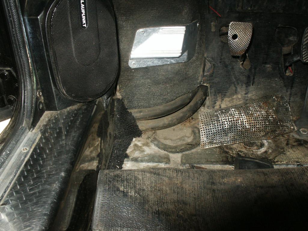

PO ran hoses to my front mounted oil cooler through the pass side long. He came out of the long and into the front trunk in the same way SirAndy described.
Works great but you lose heat on that side of the car. At some point soon I plan to re-run them under the pass side rocker cover (similar to the way the gas vapor recovery lines are run on the driver's side).
