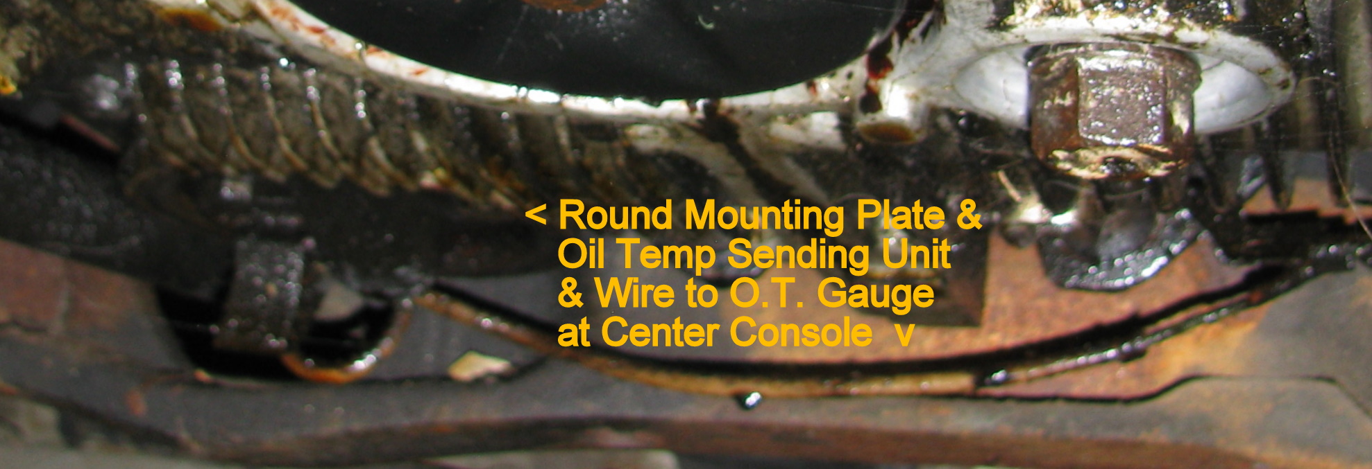

"Taco Plate" OT sensor mounting plate is forward left of the oil sump, with the wire coming out the front, as in pic of mine below.
