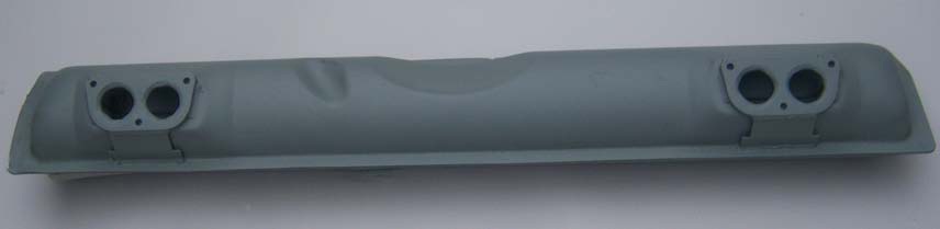

So it bolts up fine to the heat exchangers, but when I bolt the tip on. It angles too far upward and I hits the rear of the car. I bought this from a seller saying it was for a 914. But I think it might be for ?? Mis-built and that was by it was sold ??
Let me know who you think.

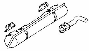

Here are images from the AA catalog and from the web. It looks like the part number should be 021 251 053C.

Seems like someone really screwed up making that muffler. They're supposed to fit on a bus or a 914 or on a 412. The indentations are meant for clearing the tin and the oil fill in a bus setup, but, since the single hole on the flange needs to go up, it seems they've welded the flanges on upside-down.

Note the indentations in the middle of the muffler. If I flipped the Dansk muffler those indentations would match up with my original muffler and the tip would be on passenger side.

But no matter what heater box you attach it to, it has to go with the single hole on the top, the double on the bottom. Seems the only good option is to re-weld the tailpipe.

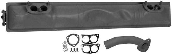

About the dansk muffler, it looks like right in Automotion's pic. Maybe they did a bad run, or just that one? Seems like there may be more issues with fitment; they really are on upside-down.
(IMG:http://www.914world.com/bbs2/uploads_offsite/htsmall.automotion.com-11782-1322542735.1.jpg)
http://www.automotion.com/dansk-original-s...-1970-1974.html

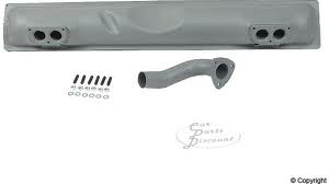

Here is a picture from one of my distributors that calls this muffler out for a 1.7 914. Dansk may have it wrong or it may be the dist. that has not been paying attention. The part number for the pictured muffler is 021 251 053 C.
