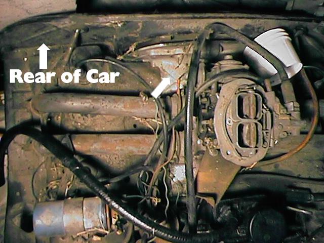

Check top of the case near the other end, right under the plenum, passenger side
Could also be a remanufactured motor...factor did that

(IMG:style_emoticons/default/agree.gif) check in the 1.7/1.8 location.
(IMG:http://www.914world.com/bbs2/uploads_offsite/www.pelicanparts.com-419-1322543796.1.jpg)

Looks like an OEM "replacement or rebuilt" block. They were supposed to stamp that location with a special replacement block ID using steel punch letters. If neither of the other location have the punched #s, then check out the Pelican archives on how to read this.
