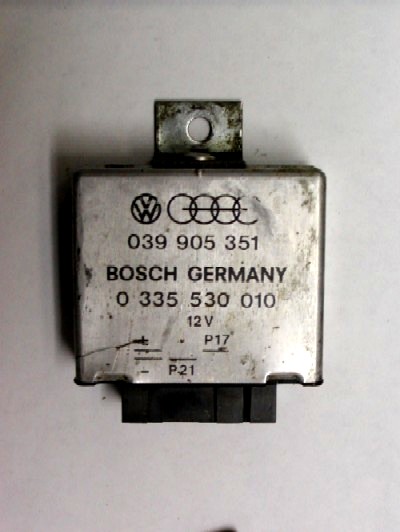

That's a CA-only speed limiter circuit...details on my harness webpage at the link in my signature block below.
Yes...it will run without it, just unplug it.

Speed control module limits rpm by shutting down injectors at a pre specified rpm. Car will run just fine without it, but you will not have over rev safety. My 76 California model has one. The cars with the additional cat and egr dash lights have the speed module.

Possibly: 49 state cars used rev limiting rotors which cut ignition but not fuel. And in CA they used the speed limiter to cut the fuel so they were not dumping Raw fuel into the cat.

I believe that to be the case. ECU on these cars had overrun fuel cut-off and and over-rev fuel cut-off (module) to prevent cat from overheating hence the thermocouple (cat temp module in rear trunk) and warning light on dash which flashes when a overheated cat is detected.

I have a California 76 car and it had the silver box your extra connection probably plugged into. I removed it with the rest of the pollution control and never missed it.

I think that the box shorts out the trigger points signals (to ground), so you get no injection events.
