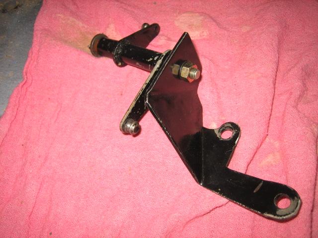

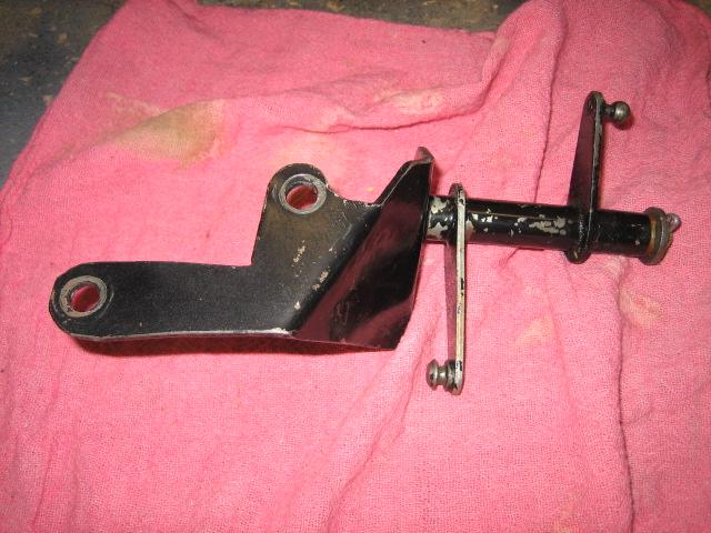

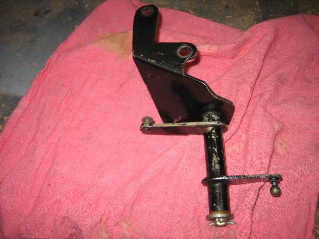

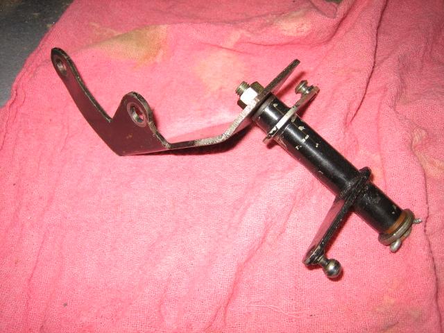

Hey guys, just found my the bellcrank for the accelerator off of my Dads 914/6. I'll need to reproduce it for my purposes, but is anyone else interested in this?

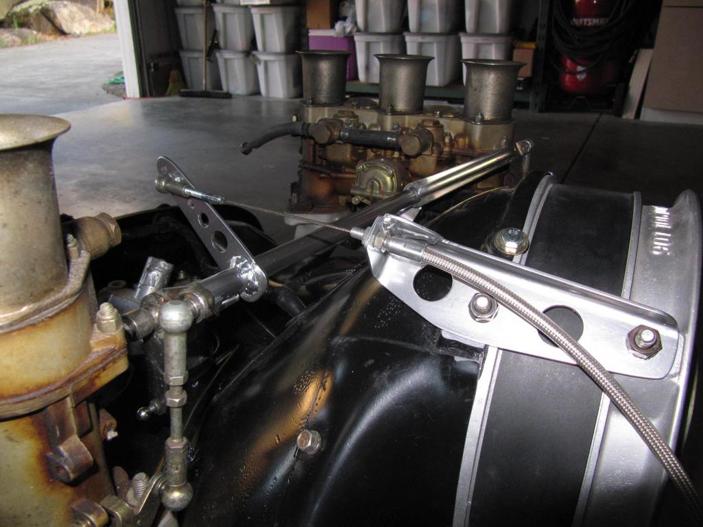

Not to derail your question but this might be interesting idea for Plug-and-play linkage. I bought this and was told it is a conversion linkage that PP use to sell but haven't been able to confirm and have no idea who produced it. I also heard it's no longer produced. Bracket looks like it would be easy to reproduce.
Kev

QUOTE(kconway @ Dec 14 2011, 05:56 PM) *
Kev
A friend of mine has something like this setup on his 6. He also converted to a side shift trans and hasn't had any problems with it in 20+ years. You do need to use a 6 cable and other linkage.
