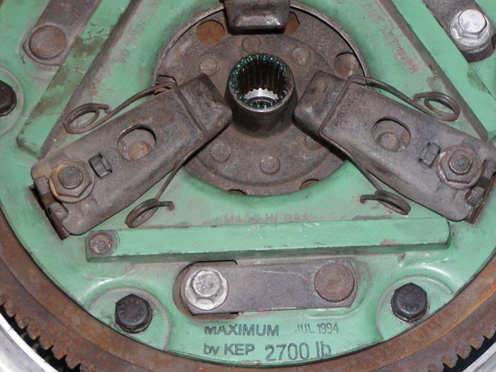

Sooo... Recieved my T/O bearing yesterday... Today Im trying to put it in.. We... As you can see. its exactly the same as the stock one. Did I tell the lady at KEP the wrong thing?? I told her its for a 901 trani, for use on a v8 with their KEP clutch/pressure plate package.
What to do?

Pressure plate..

See if the fingers line up perfectly with the stocker they sent.
That old school pressure plate may use a stock throwout bearing.
2700lb ?? Your clutch tube will hate you and your left leg will be bigger than your right leg.

Save yourself the headache NOW and buy a new clutch assembly BEFORE you assemble this setup.
I really really wish you would have told me about the clutch arm extender... this would have ended this thread and the others many moons ago.
The extender does away with the need for the thicker KEP throw out bearing. The problem is: whether or not you have enough room for the throw out bearing arm to fully move back before hitting the case.
It sounds like you have everything you need to make it happen.

How did the conversation with KEP go ?? Did you tell them it was a Green 2700lb 3 finger pressure plate on a 215mm flywheel ??

Dan,
I'm concerned about this for one reason: Very early in my conversion carreer I had a very powerful V8 914 customer car that would smoke clutch after clutch... it finally came down to the wrong throwout bearing. I want yours to be correct the first time. No guessing. No questions. With the wrong throw out bearing you can adjust the clutch to disengage but it would NOT disengage completely. It will slip.

Yes. That is how they are getting away with the stock style throw out bearing. Put it together.

Brad, I told them it was for a 901 trani to their 215mm clutch/pressure plate assymbly.
