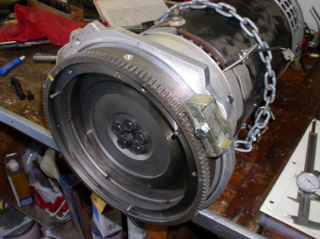

Just a few progress pics for the curious. It's not a huge amount of progress but at least it feels like the project is starting to move forward! (IMG:style_emoticons/default/smilie_pokal.gif)
This is a pic of the taper lock hub. It's the reason for my question about flywheel distance. I have about 5 cm of play here so I needed to know where the flywheel was SUPPOSED to end up. Thank you Demick for the fantastic data dump you gave me! (IMG:style_emoticons/default/pray.gif)
The amazing thing about taper lock hubs is that you can remove the bolts completely and the thing still won't come off!

Flywheel: Demick -- the final distance was 44.2mm

Cool. So you can use a stock flywheel/pp/disc setup ?

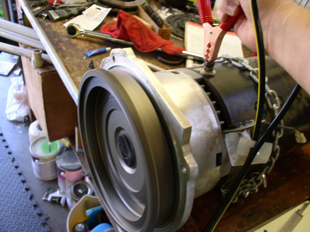

Now THIS is how to spin up a motor on the bench!!!
(and you thought your STARTER motor sucked amps!!! (IMG:style_emoticons/default/cool_shades.gif) )

Brad, yep it's stock all the way. Ok, I didn't use the engine seal thingy since I don't have any oil in my motor! (IMG:style_emoticons/default/blink.gif)

Oh and just cuz... here is the P. Plate:
