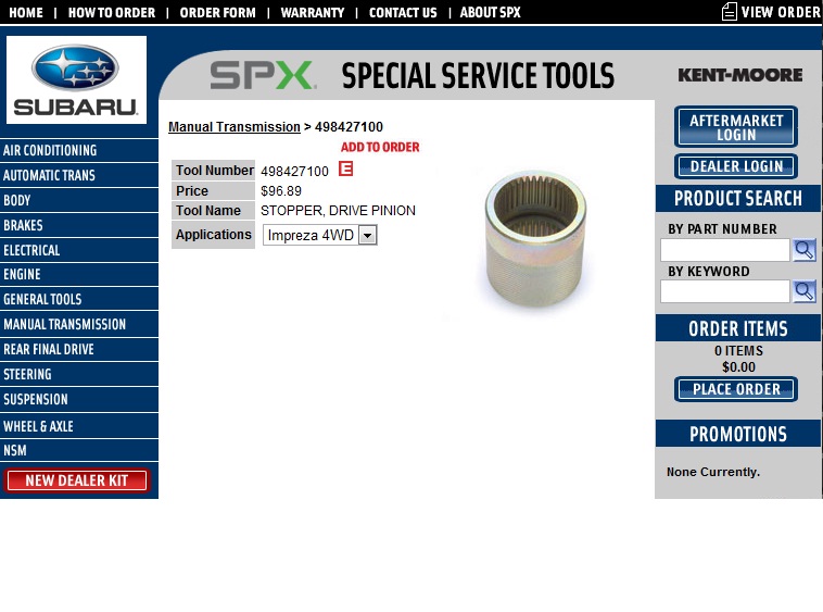

Whats your plan for locking up the center diff on the Subaru transaxle? Do a google search for Kent Moore tools #498427100. This is the locking sleeve that Subaru dealers use when they service the tranaxles. This and a washer will work the same as the Bremar and Subarugears ones and cost less than half. Or you could cut and weld the diff up.
You can sell your center diff for more than the price of the tool.

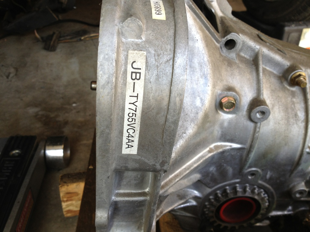

Do you think this part will be as strong as the Bremar spool?

QUOTE(BIGKAT_83 @ Mar 16 2012, 03:24 PM) *
Do a google search for Kent Moore tools #498427100. This is the locking sleeve...
Wow, that is a great find. Wish I would have had known about this when I built mine.
