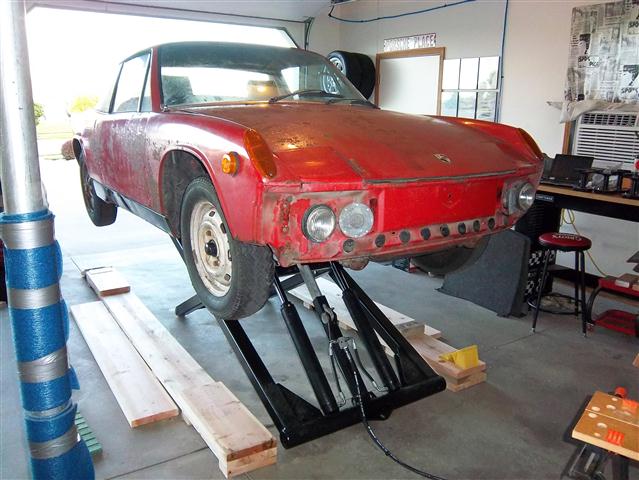

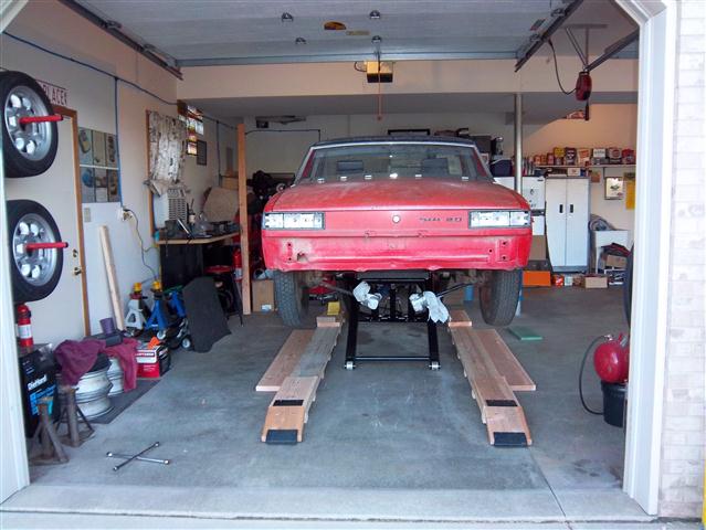

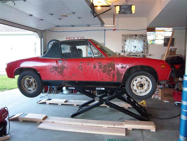

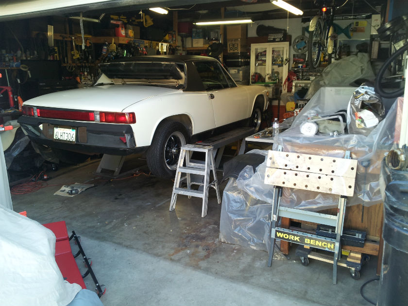

Yes I have one and love it! Best chocie if you don't have the head room for a two post lift. No problem pulling the motor, only issue is clearing over the top of the lift. I bought mine from Greg Smith equipment in Indy. Its a 6000lb lift so I can put the truck on it also if I wanted to. Gets the car 45 inches in teh air, while I can't walk under I am able to use a rolling stool. Mine was about $1500 wit tax, sure wish I would have bough tthis sooner. I followed another members plans for making ramps and it works great. Here is my project car on my lift.

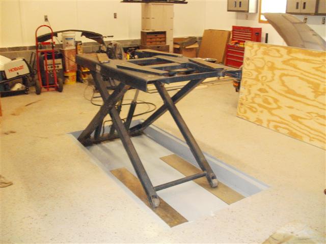

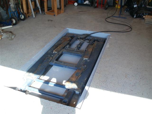

I bought my Ammco scissor used off Craigslist for $800.00 best tool I've ever purchased as far as I'm concerned. Made installing the six in my 914 a piece of cake. I ended up recessing mine into the floor.

Did you get a concrete cutting service to cut that for you?

Did you post that on "Garagejournal.com" Several projects there about recessing a lift into the floor.

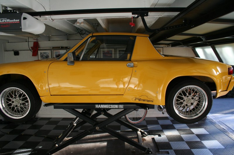

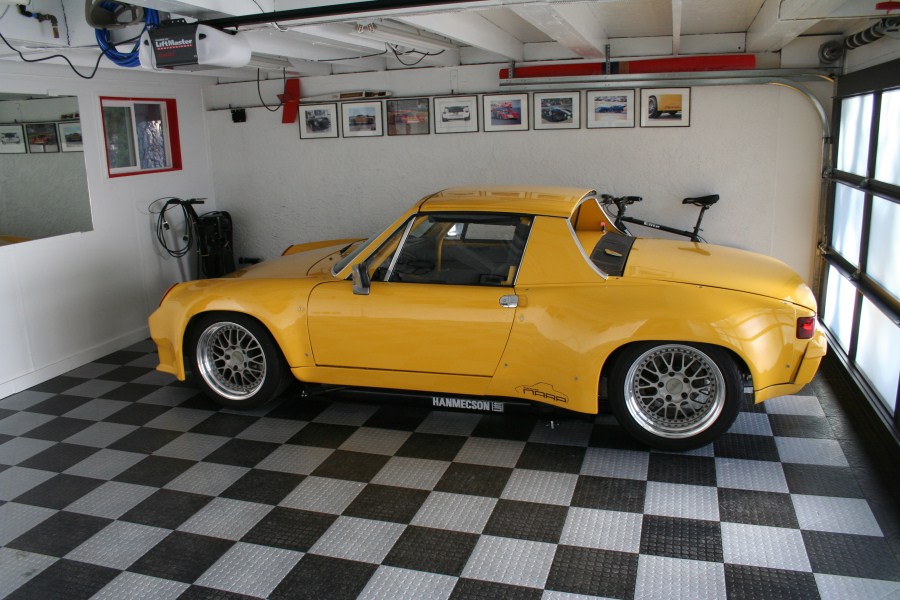

I like mine alot. It only goes up 48 inches but as you can see my ceiling won't allow much higher than that anyway. (IMG:style_emoticons/default/biggrin.gif)

QUOTE(Eric_Shea @ Jan 30 2012, 03:00 PM) *
Nope did it myself. Marked out the cut line with a sharpie pen and then rented a wet saw from H.D. and went to town. I rented the biggest they had which was a good thing because the concrete was 6-8 inches thick. Then rented a electric jackhammer and busted it up. Placed some rebar in and then made a floating form. Called a concrete company to come and pour/level/finish. Came out great but I will NEVER do that again.........hard work !!! (IMG:style_emoticons/default/biggrin.gif)
