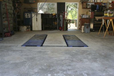

I bought my Ammco scissor used off Craigslist for $800.00 best tool I've ever purchased as far as I'm concerned. Made installing the six in my 914 a piece of cake. I ended up recessing mine into the floor.
Eric_Shea
Did you get a concrete cutting service to cut that for you?
Jacob
Did you post that on "Garagejournal.com" Several projects there about recessing a lift into the floor.

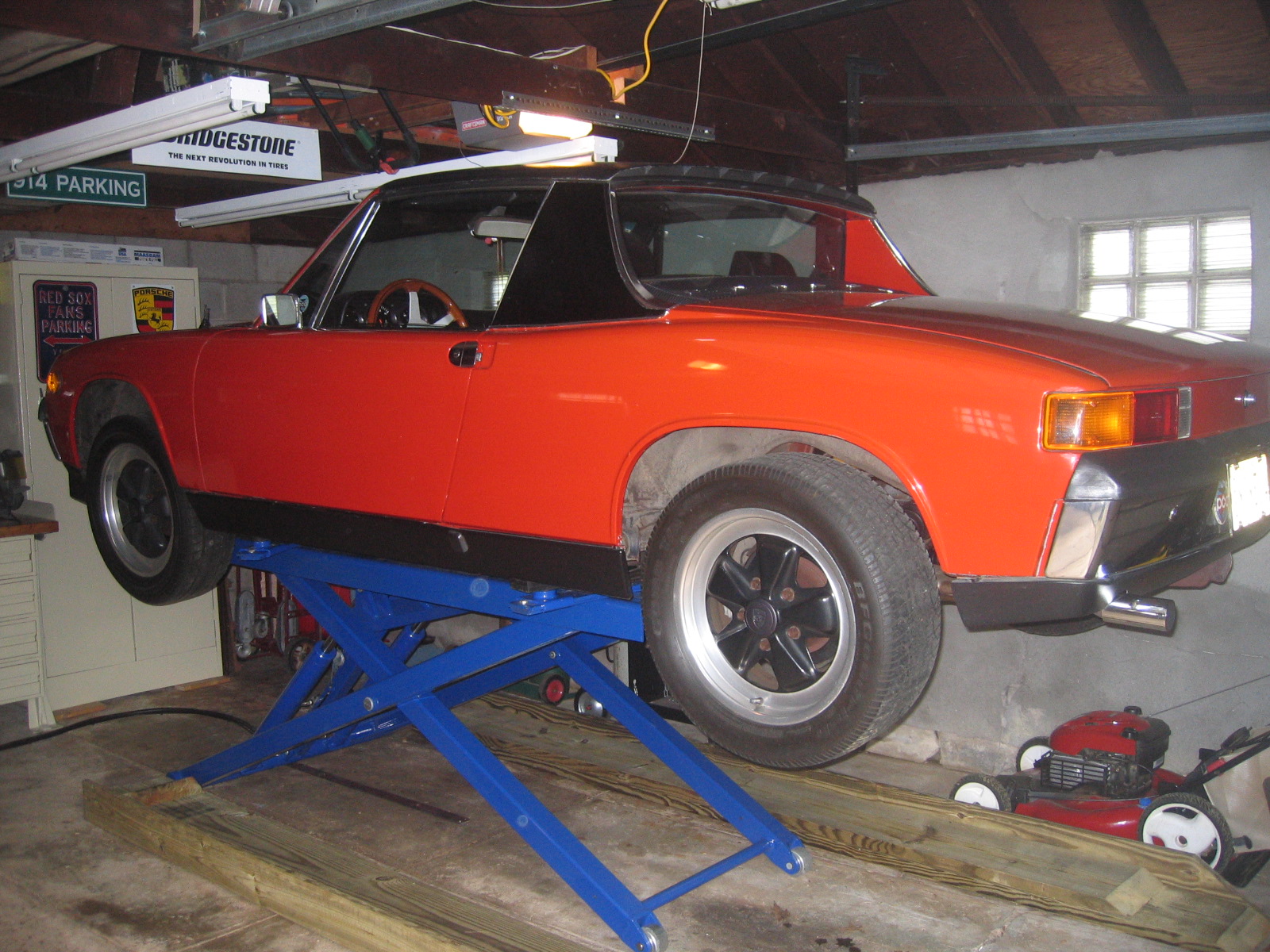

I went on the low end and found a tire chief on CL...about $350 I can do most repairs and there is room also to drop the motor.

Nope did it myself. Marked out the cut line with a sharpie pen and then rented a wet saw from H.D. and went to town. I rented the biggest they had which was a good thing because the concrete was 6-8 inches thick. Then rented a electric jackhammer and busted it up. Placed some rebar in and then made a floating form. Called a concrete company to come and pour/level/finish. Came out great but I will NEVER do that again.........hard work !!! biggrin.gif

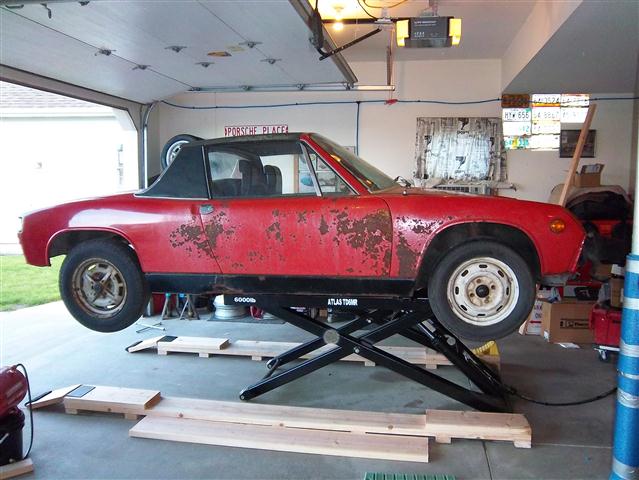

Found a snap on 3500lb scissor lift. It is about 12 years old & everything works great. Guy wants $900 for it & I am waiting for full size pics in my email. Supposed to get them in an hour or so. Should I not jump on it? Oh it lifts up to 35"
KELTY360
35" lift and 3500 capacity isn't very much. I know it's a Snap-On, but it think I'd keep looking.

Yeah I am going to pass. Unless he makes me a deal I can't refuse. I am going to buy a nice lift. Even if I have to sell my enclosed trailer to do it. I found a good little tilt trailer to haul my cars on. So my enclosed trailer is an extra luxury. I would sure as hell get more use out of a lift. I may just be putting my Enclosed trailer up for sale. I could buy a new lift no problem then.
Here is a pic of the lift
JRust
So after considering selling my enclosed trailer. I decided it was a good idea. I will get so much more use out of the lift. I listed it last night on Craigslist & here. Sold it to the first guy who called on it. Kinda bummed to have sold it sad.gif . Although I only have a deposit. It being the weekend they didn't have all the cash. I get it monday after work. Which works just fine as I called about my brand new lift. It is made by Quality lifts & will run me $1750 delivered & setup. Here are the specs

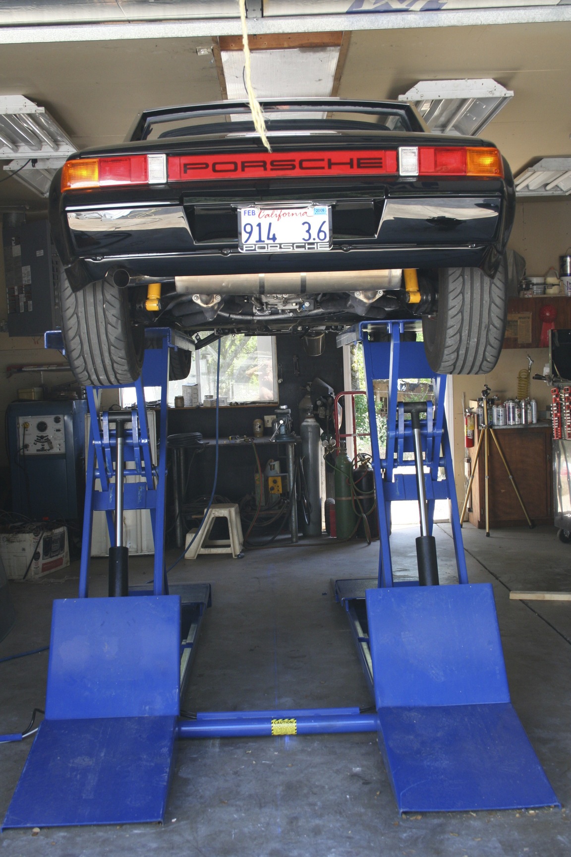

PRS914-6
Just a word of caution as I found this out the hard way....
When these companies rate their lifts at 48" that is the full lift height off the ground with all attachments installed. Sounds great huh? Well that's not actual lift, you have to subtract the amount of height when it's collapsed (with all the attachments on) and that might be 8 inches to give you an actual lift of 40". It's a really crappy way to rate them. You need to ask how much actual "hydraulic lift" they have. That means the actual MOVEMENT upward and that is far less than the specs. Unfortunately 80% of the companies can't even tell you that spec or understand it.
After learning the hard way I bought a nice Bend Pak SP-7 with a 6 foot lift and sunk it in the concrete. Here are two pics on top of the concrete and then after I sunk it. It's an awesome lift that you can stand under, not crawl under. I'm getting too old for that crawling routine.

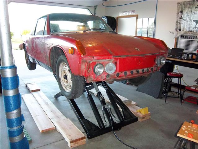

Okay Reviving this older thread. I didn't end up buying one last time around. I am buying a Bend Pak MD-6XP this saturday. It is a year old & the guy bought a 2 post lift for his shop instead. I am buying it for $1200 & it's about $1800 new without freight. I've been watching for quite a while & for a good quality lift. This looks to be a good price. I went away from the harbor freight lift. While I like to buy the random tool there that I don't use every day. The thought of putting myself under one of their lifts was wacko.gif for any length of time. I will get some picks up as soon as I get back. I'll need to make some ramps to sit on the sides. At least until it is in the air
jbyron
Wow, looks great Jamie. The black thing in the pic - does it come with it's own compressor, so you don't have to use shop air to run it?
-Jamie (the Other Jamie, I guess)
JRust
QUOTE(jbyron @ Dec 12 2012, 12:57 PM) *
Yeah it runs off 110 even. That also is it's little dolly for moving it around. I am way stoked to get it. I'm even picking up a 914 on the same run piratenanner.gif
