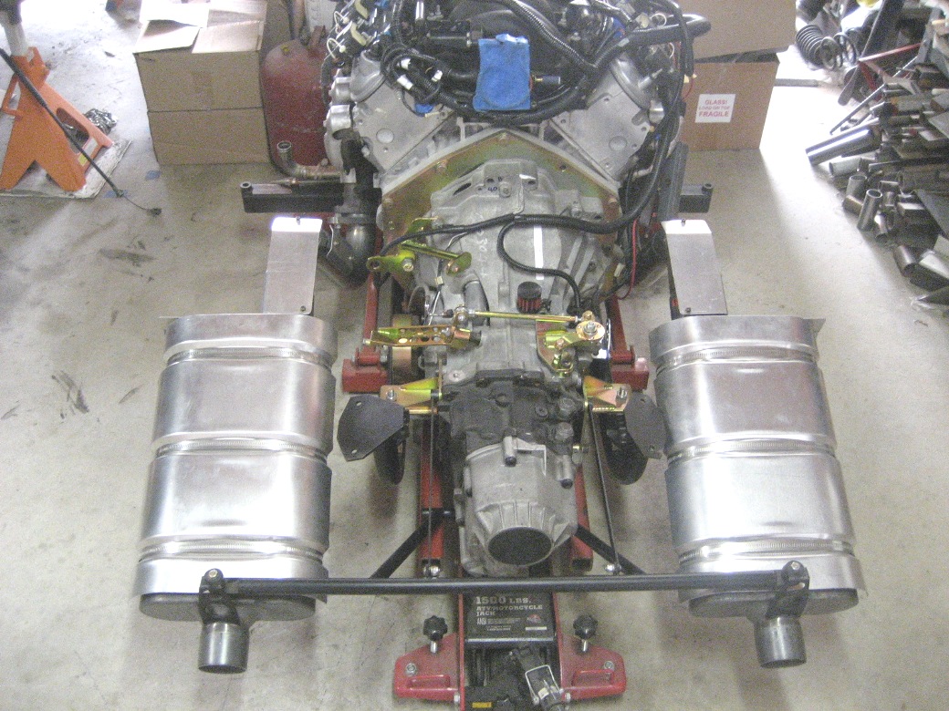

Over the axles.
Andys

QUOTE(andys @ Feb 14 2012, 12:06 PM) *
Over the axles.
Andys
Did you just weld up a bunch of pipes, have them bent, or is it the ass end of an available kit (like an axle back section of a mustang as an example)?
Thanks
andys
post Feb 14 2012, 01:20 PM
Posts: 2,165
Joined: 21-May 03
From: Valencia, CA
Member No.: 721
QUOTE(bulitt @ Feb 14 2012, 11:07 AM) *
Over the axles.
Andys
Thanks
I bought stainless mandrel bends from Summit and TIG welded them together. Mufflers are FlowMaster 3 chambered for reduced interior noise.
A note on heat shielding: don't forget to shield the shocks in the event your muffler or pipe is close; no need to heat up the shocks un-necessarily. Can't see it in the photo, but there's a shield between the shock and the muffler.
Andys
