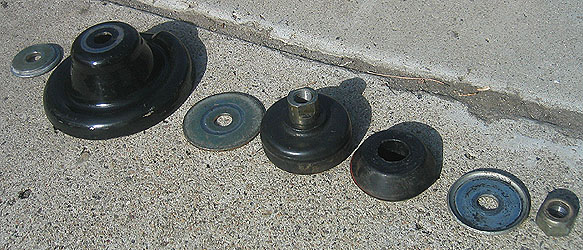

How do I attach them using the zip-ties. Should I drill some holes in the spring perch?
Also the car had older Koni shocks on it. I'm not sure of the order of the parts. I looked at the service manual and it is not 100% clear. There are no supplementary springs either. Should I get some?

Chris,
Check the Haynes 914 manual, page 94, for an exploded diagram of the shock/sping assembly. It does show a supplemental rubber spring on the shock rod.

QUOTE(maf914 @ Sep 11 2004, 09:14 AM)
except that the Haynes does not show a Bilstein installation. Konis need a bump rubber, Bilsteins don't.
that said, i usually do install them, but i cut at least one of the rings off...

I was at a local PCA meeting once, held at the Bilstein warehouse in CT. We were told by their rep. that a bump rubber is required. I think only a small rubber/plastic spacer may be needed to prevent the internals from bottoming and damaging the valve assembly, nothing as big as the original Boge bump rubbers.

You shouldn't have to tie up the springs with 140lb springs.
I only had to do this with 180lb springs.
The bilstein rears have an adjustable perch.
Just the move circlip up below the plate until the slop is gone.
I'm running bilsteins with weltmeister 140lbs springs and I don't have this problem.
I only had to tie up the hats with 180lb springs because they are shorter.
I'm also using the stock hats with the stock rubber piece on the top.
Steve
