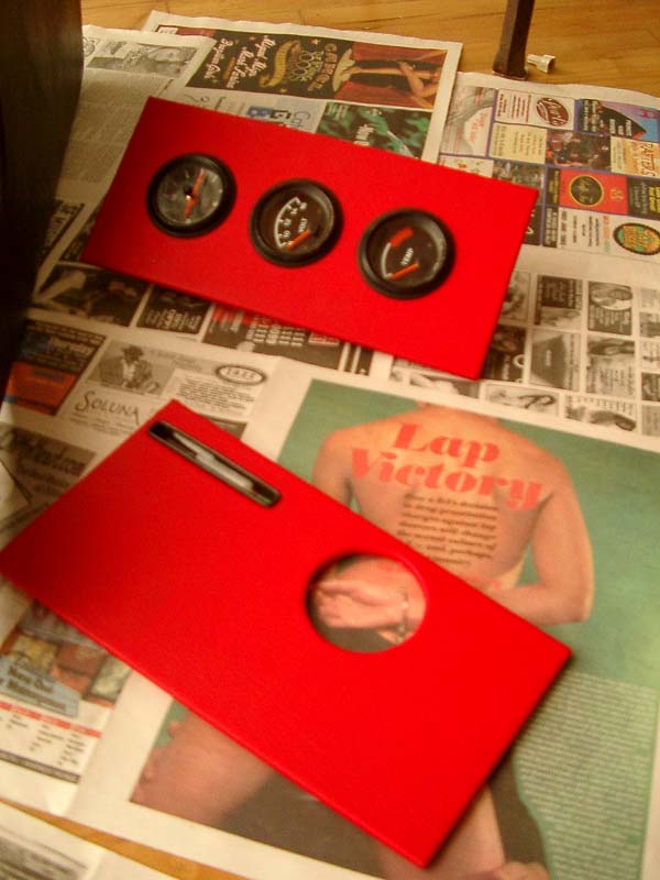

so, last week i decided it was time to tackle my ugly ripped console and dash face. i got everything out, took off the old vinyl and cleaned it all up.
went and got myself some black and red vinyl and contact cement.
3 days later:

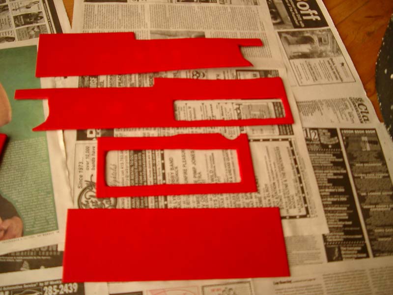

more

no holes yet ...

more ...

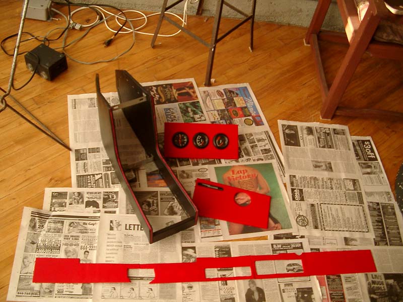

QUOTE(STL914 @ Sep 11 2004, 07:57 PM)
Where'd you find the red edging material used on the console?
red electrical wire! (IMG:style_emoticons/default/laugh.gif)
works great. the edge of the console is plastic with a large groove. i cut the vinyl from both sides to meet right in the middle, then pressed in the wire. i fucked up on a few spots, but that was because of my cutting. it looks great otherwise.
i have no idea how to stitch vinyl, so this was a fairly easy option.
i'll install it tomorrow and post more pics,
(IMG:style_emoticons/default/cool.gif) Andy

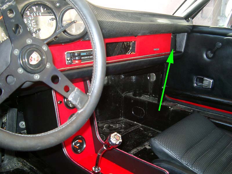

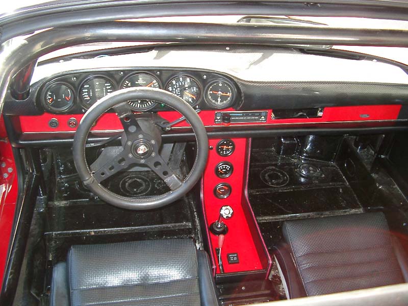

done !

what i have learned this weekend:
lesson 1: don't assume anything to be the way you would like it to be. TEST-FIT everything before you put the double sided tape on it. (IMG:style_emoticons/default/headbang.gif)
lesson 2: early style dash face plates don't fit very well around a late style steering column! (IMG:style_emoticons/default/headbang.gif)
lesson 3: don't get dirty grease on your fingers when you handle bright colored vinyl! (IMG:style_emoticons/default/headbang.gif)
lesson 4: a rollcage crossbar can interfere with the lower dash in a way that it moves just enough down to leave a small gap between the dash face and the chrome lip. (IMG:style_emoticons/default/headbang.gif)
lesson 5: there are *NO* tolerances inbetween the plates, even the thickness of wrap around the edges vinyl is too much and the next piece won't fit right! (IMG:style_emoticons/default/headbang.gif)
lesson 6: make sure you have *all* pieces needed to finish the job! (IMG:style_emoticons/default/headbang.gif)
lesson 7: don't get mad at the chrome trim around the heater controls. yes, you'll get it off with brute force but it won't be pretty! (IMG:style_emoticons/default/headbang.gif)
lesson 8: never, ever, sandblast the entire car! (IMG:style_emoticons/default/headbang.gif)

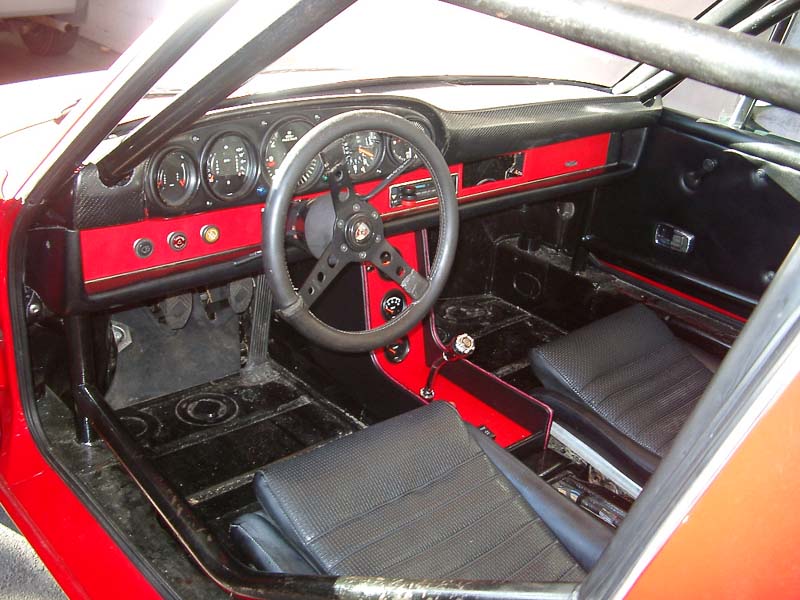

piece missing ...
i has been over 2 years since i took those dash pieces off, so i guess i just lost the last one that goes in the far corner. oh well, gotta redo the whole thing anyways.

more ...

Great work on the dash bits. I've been avoiding a center console, as I rather like the open center section, but I'm reconsidering with such a nice job done. That roll cage also looks much easier to live with day to day than many I've seen. In particular, I like the forward position of the downtube near the A-pillar. Most are back farther (to clear the dash, rather than go through it), but that makes getting out a lot harder, esp. for those of us with older, stiffer bodies.
