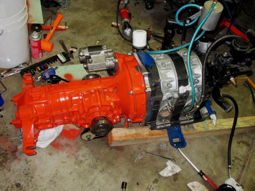

Anyway, got the adapter,flywheel,clutch on the new motor. Mounted the freshly sealed and painted tranny. Yes, painted... So what... (IMG:style_emoticons/default/biggrin.gif) I plan to get it dry fitted into the car and look at the cross bar mods. I hope to keep both engine mounts on the same cross bar. Looks like it will work and will allow the reuse of the blown motor once it gets rebuilt.

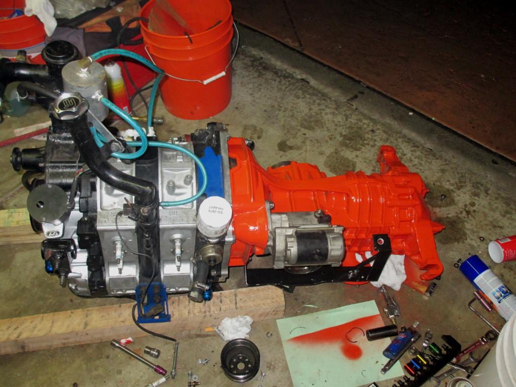

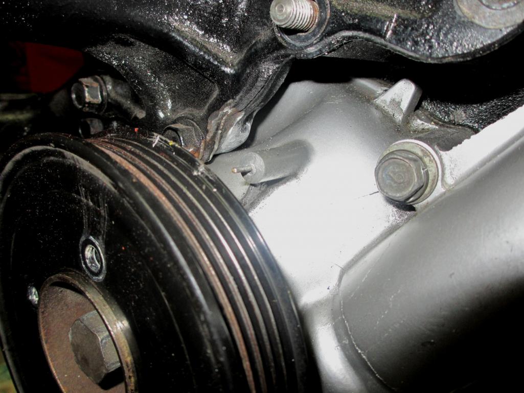

Here is the engine mated to the tranny... I only had to pull off the upper intake manifold to remove the engine. And, that was only due to the lack of a proper lift. All accessories will bolt on before reinstallation.
Here you can just see the tab on the black water pump housing I had to grind for clearance. The later oil pump cover has a divot to clear this tab. This is a common mod when using this setup. The main advantage is the mechanical control of the oil meetering pump. The electronic control I was using is a POS. The guy that sells it is too hard to get hold of in Austrailia. So the simple cable setup will work every time.

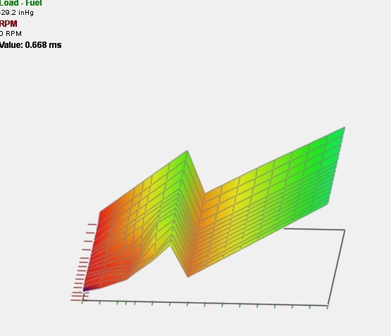

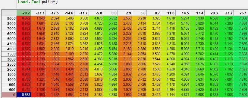

Well the engine will be in this weekend but it wont be running. The primaty fuel rail will not work. Time for a custom fuel rail. I have the rail stock (3 feet), but drilling and tapping is a PITA on aluminum. I might send the tapping out to a maching shop. That will prevent me from having to build the rail multiple times. (IMG:style_emoticons/default/dry.gif) This fiasco will allow me to finally install my 1000cc primary injectors. right now I'm still running the stock 550cc primary with my 2000cc secondary injectors. This will require some fine EFI tuning but nothing too bad.
Here is the fuel map. The primary injectors function like a normal injector up to 1.7psi. At that point, they maintain a steady pulse width up to 30psi. At 1.7psi, the secondary injectors start to pulse and increase pulse width with pressure and rpm. This is normal for a rotary to use this injection staggering. I will reduce the pulse width below 1.7psi by 40-60% across the map to start tuning.
Here is the map in 3D...
The original engine I have is from a JDM car called a Enus Cosmo. This engine has a better plenumn and intake for torque than a standard Rx7. The new engine is from a USDM 89 Rx7. I have noticed that Mazda made these engines with 10 different versions of every part. maybe that is why they are so expensive. No consistency= $$$$ tooling costs.

Got the engine and tranny mocked up. I use aircraft stripper on the bar. Found some 1/4" stock and 5/8" DOM to fab the mounts. The original mounting point on the passenger side had to be trimmed to fit around the new one. Got it all welded up and it fits both engines. (IMG:style_emoticons/default/piratenanner.gif)
From the rear you can see how asymetrical the new mounts are. I think in the Rx7 this is done on the passenger side for turbo clearance.
Anyone can fab up a cross bar since the transmission locates the assembly. I hope this inspires some new unusual conversions.
