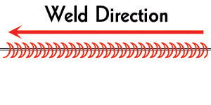

Ooops. those were CMYK 96DPI...

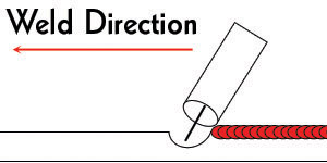

#2 (2nd time)
