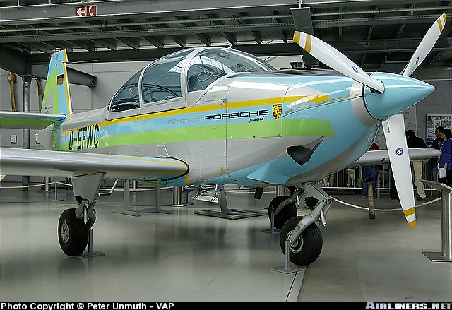

VW engines have been used in kit planes. However, the Lycoming and Continental engines were optimized for this sort of application. When Porsche was trying to break into the aviation market, I understand that things didn't work out at well and the program was scrapped after some Mooneys were built with the 911 based engine.
