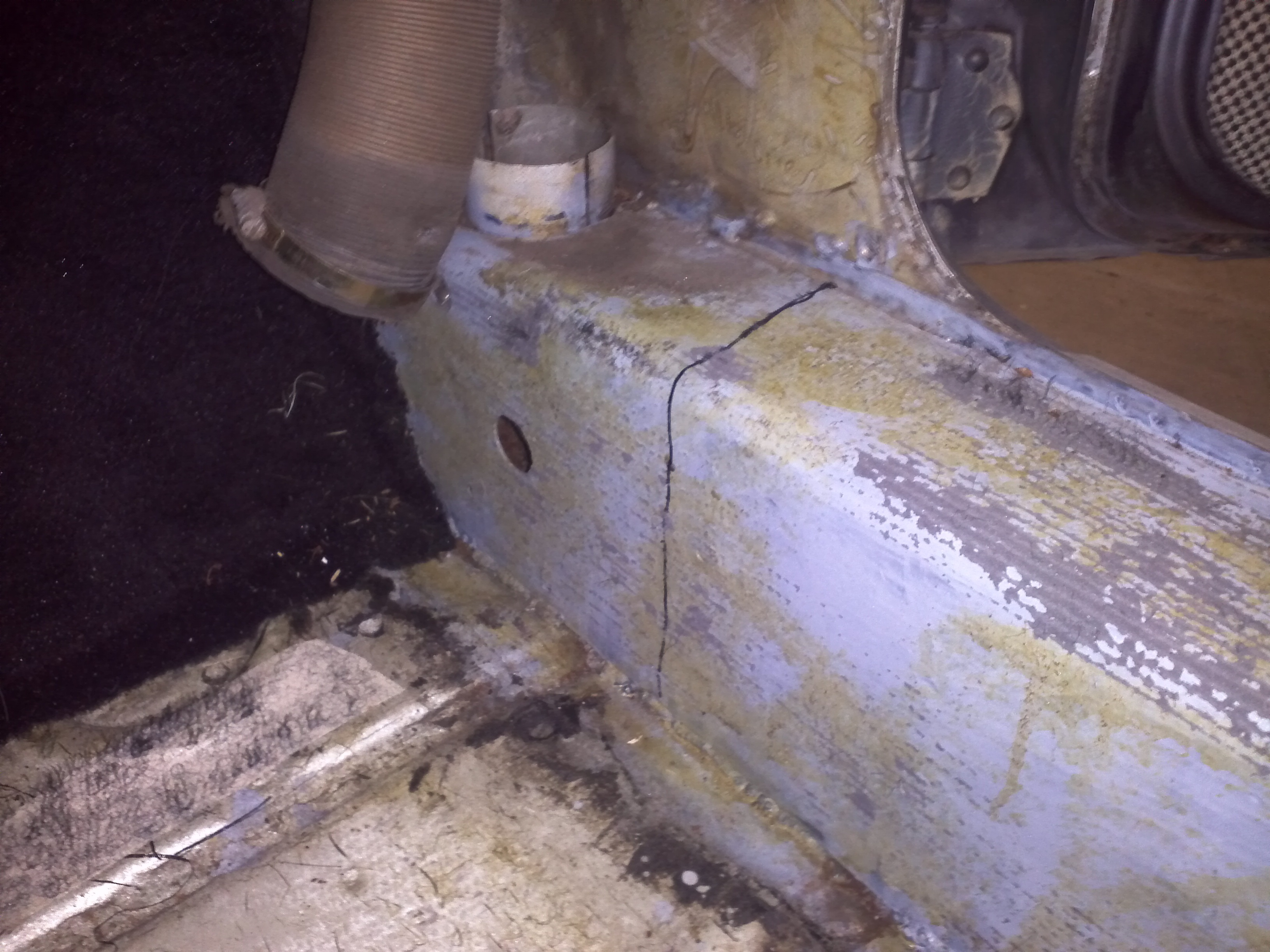

So I will make my cuts here in the front

Show me the stiffeners. I would likely cut the stiffeners not the stock inner longs.

That is the stiffener...

LOL, you're looking right at them. i did my best to make it look like i never installed one - and yes, i would only cut through the stiffener and not through the longs.
Oh, ya ok... Yes just through the stiffener. Be sure to remove the catches. Take your time. Measure twice then measure again. Make yourself a diagram to keep track of your progress. Brace the openings after you get them set before welding. (IMG:style_emoticons/default/welder.gif)
