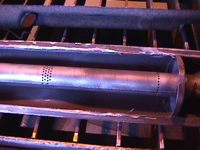

Here is a stock exhaust from the inside out. The four headers port into the outsides and then go into the center section from the ends through the center pipe. All the engine exhaust goes throught the tiny holes in the center then to the outlet pipe to exhaust.
Any wonder why thye say that stock exhaust doesn't breath?
Don't ask me why I cut it apart! (IMG:style_emoticons/default/rolleyes.gif)

tracks914
post Sep 27 2004, 06:25 PM
Canadian Member
Posts: 2,083
Joined: 15-January 03
From: Timmins, Ontario, Canada
Member No.: 153
And another.
