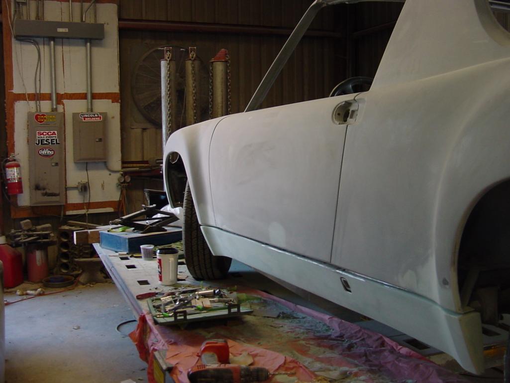

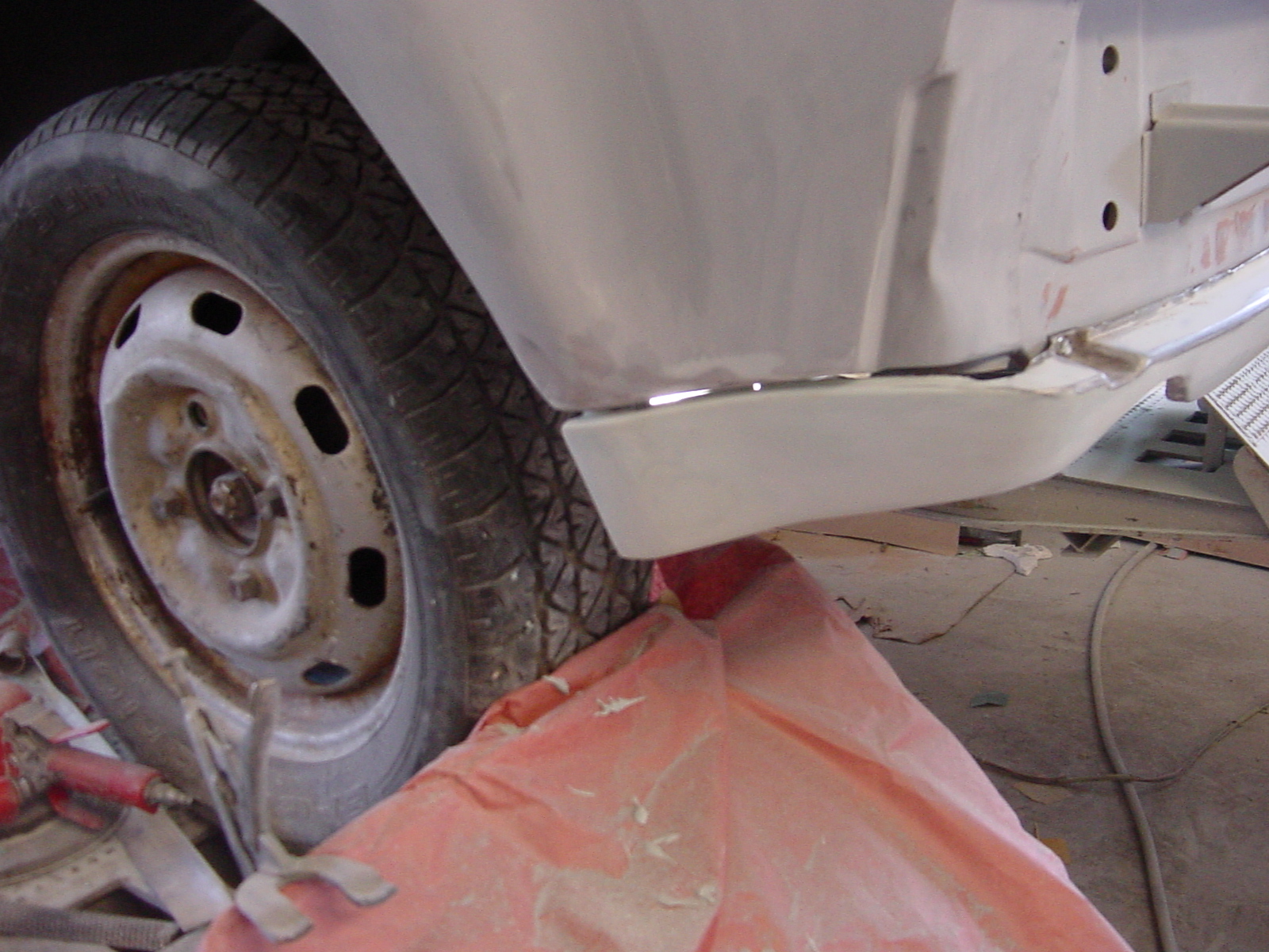

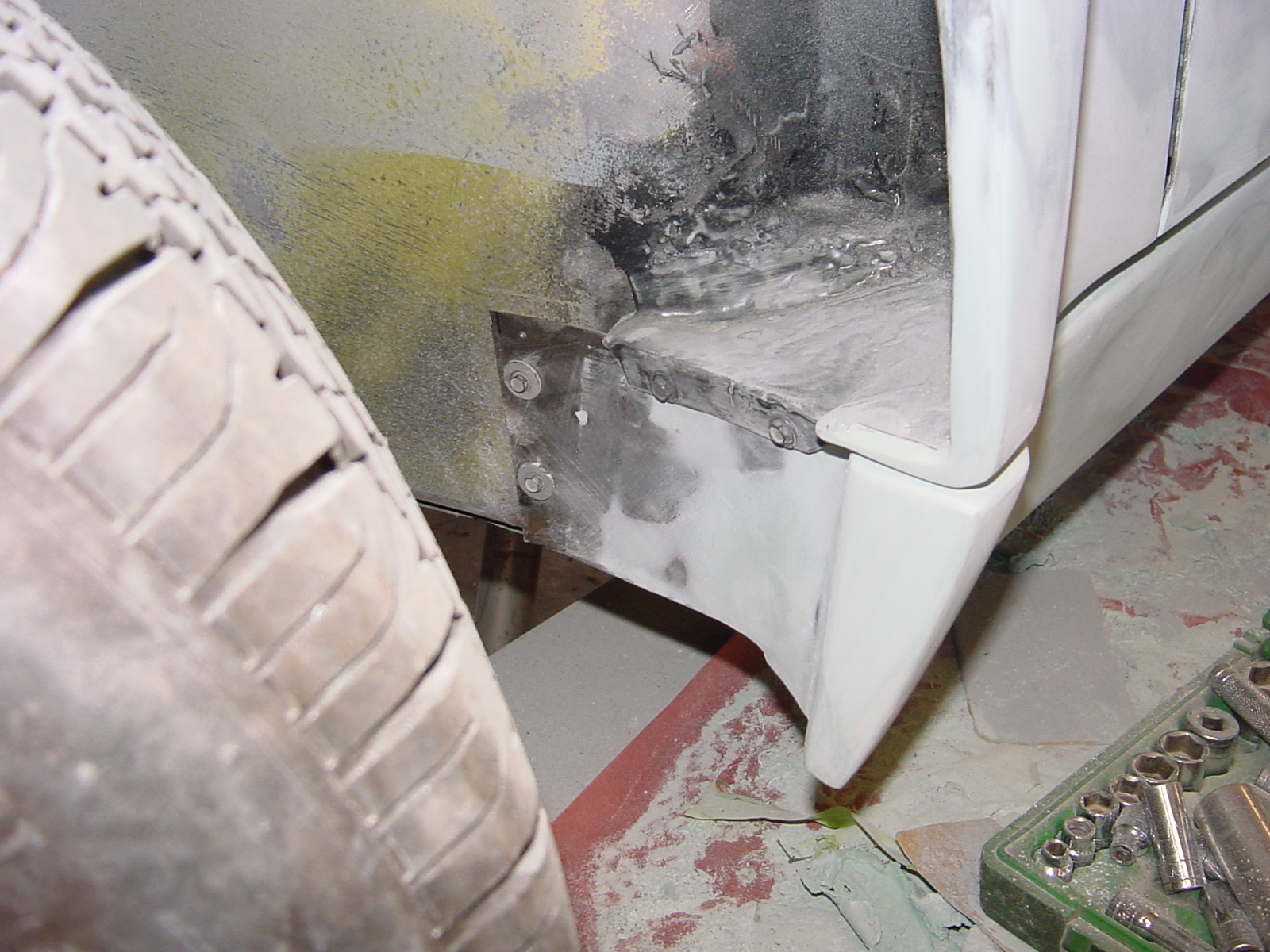

I had both my rockers and valences done when the body shop put on the flares. They look great. But there is no one that I know of who is actually doing this for sale.

Here are some pictures of my car while it was at the body shop.
