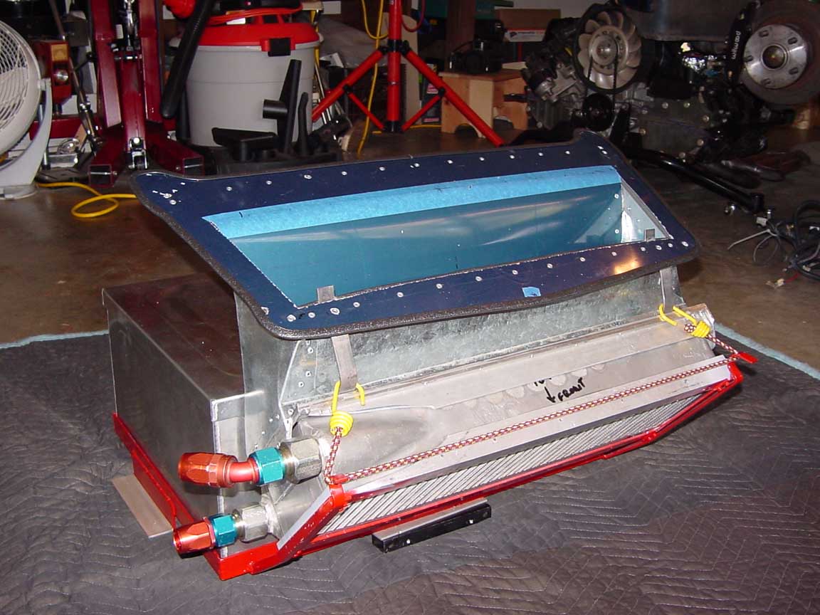

Mine is a 15 gallon cell and, with this large oil cooler there it wouldn't fit into the front compartment. So I had to cut a slot into the middle bulkhead for the top edge of the cell to slip underneath.
There is a single frame (red in these pictures) for both the cell and the oil cooler with the same criteria you had about getting them out in a hurry. The frame and lower ducting is riveted into the trunk but everything above that is removable in a hurry. I have to remove the exit duct with two screws and two toggles. Then unbolt two bolts to remove the front strap and the cell out slips out forward... takes 8 minutes max and I don't have to remove the oil cooler.
The cell is held in with a tab at the back edge and a strap across the front that's bolted onto the divider found in late cars. I think these pix tell the story.
The last pic shows the driver's side of the front strap and both the cooler duct fasteners on that side as well.
Good luck!

QUOTE(pcar916 @ Mar 28 2012, 02:20 PM) *
Good luck!
That is a very slick setup Ron!
It is easy to forget that things have to be serviced and do something that makes it really hard.
John

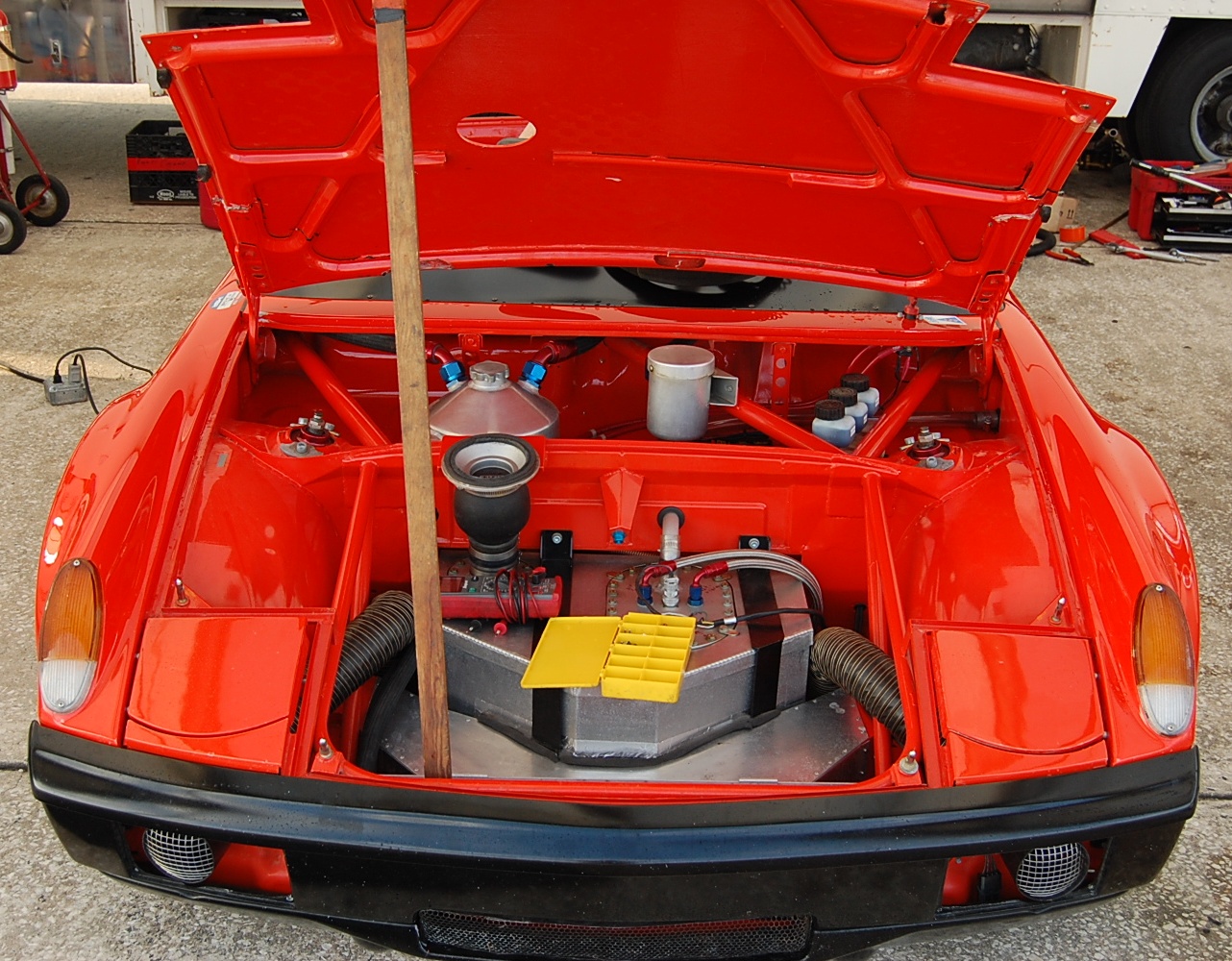

This is from Sebring SVRA a few weeks ago. Submitted for your viewing pleasure

You Ain't Kiddin. Just wondering why they added the Brake Duct ( Dryer Hose looking) vs just using that air-flow from the Oil Cooler?
