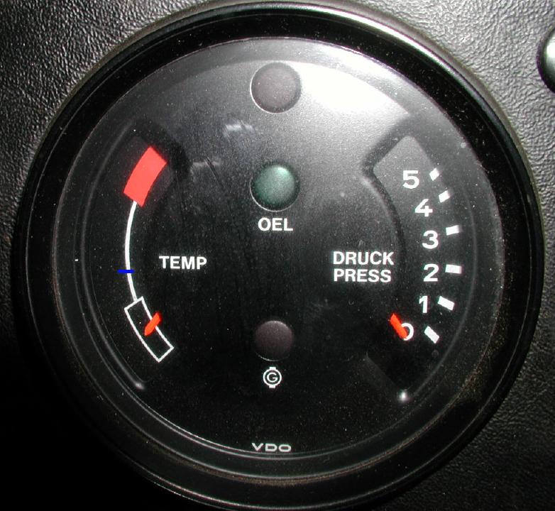

If it is the 911 style dual side gauge like the one pictured then you can just unscrew a fuel gauge and put it in the place of the oil press, but it will still say druk on it. Each side just unscrews from the back. The other way to go about it is to get a VDO fuel gauge that reads from 10-180 ohms. they are like $40. Or, if you have the 911 fuel gauge you can put it into a 2 1/16" fitting. I have gauge for the 911 style, and for if you just want to put a stock 914 fuel gauge into your combo gauge.

Here is the 911 gauge

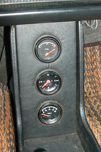

I did the conversion of a stock oil TEMP center console gauge to a fuel gauge using the guts off a 914 combo gas gauge.
Was easy....
I looked everywhere and even ordered the VDO gauge and got ones with the wrong ohm range both times. Pissed me off so I figured it out in a afternoon. Looks stock too.
If you want Eddie I can make you up one if you supply the parts.

I find the triple gauge to busy as all the gauges are smashed in and just off center. Using a 911 combo and a small fuel gauge is really clean. I don't need to look at the fuel gauge when racing but I do glance at the oil temp and pressure on the track and I want to find out that info quickly!
The cockpit VDO gauge is smaller also so it doesn't fit oem style in a center console. I know I am being CW but I don't like to hack.
