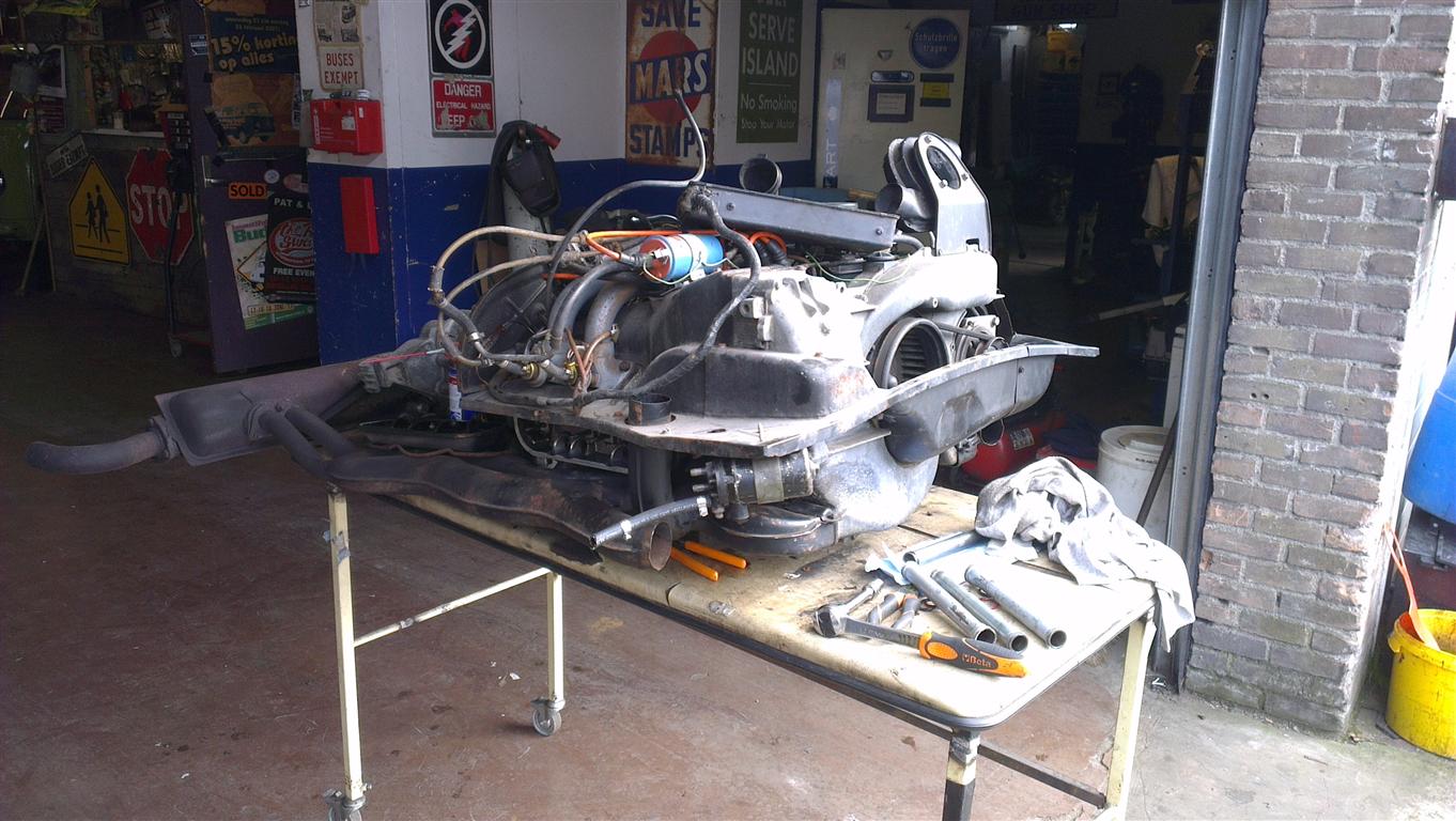

Engine and gearbox ready to be mounted back in the car:
And as a true dutchmen, off course orange HT leads:
Next weekend I'll try to put the engine and gearbox, back in the place they belong (IMG:style_emoticons/default/smile.gif)

So a few weeks later:
Engine back in the car. Easy job, I expected it to be more difficult, but it was lower the car and an hour later done. And that for a 914 noob (IMG:style_emoticons/default/smile.gif)

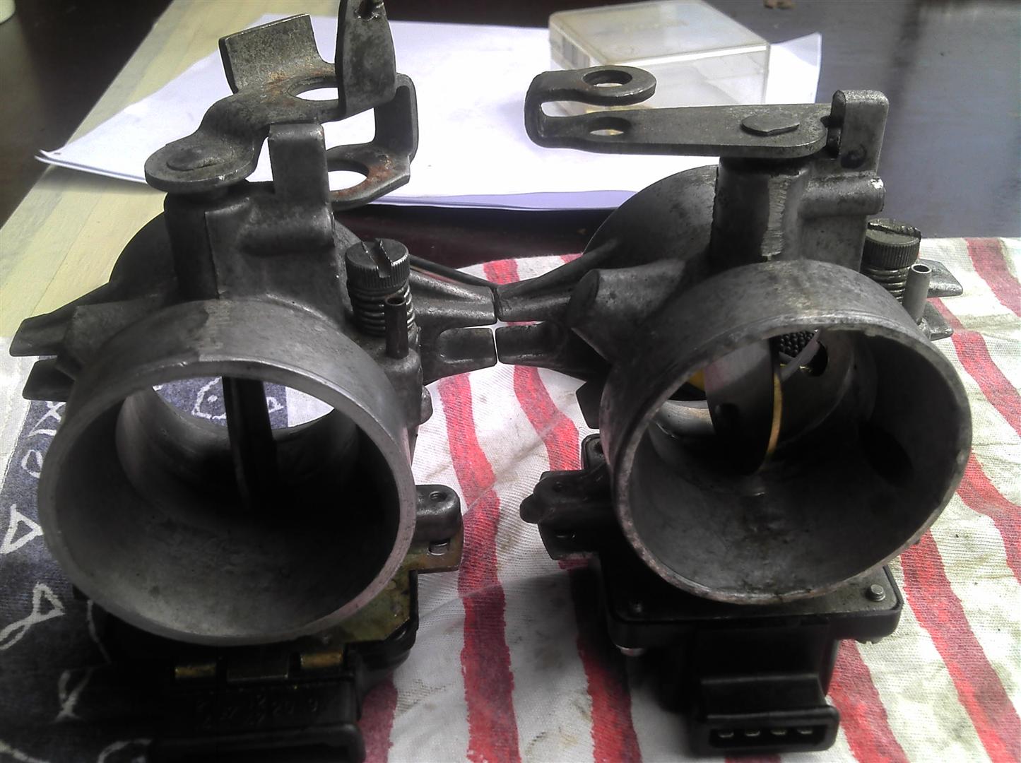

After the easy part, the fuses where blowing every time I hit the key, some big malfunction in the FI harness, and a short cut in the ignition didn't help either I think I was (IMG:style_emoticons/default/yellowsleep[1].gif) while rebuilding the ignition, and connecting the harness.....
Luckily I found a spare FI harness and ecu (1 year later model I think, with a knob on the ecu?), only problem was that the matching throttle house did not work with the position of the throttle cable (left new one, right old one).
After a bit of grinding and welding, she works excellent now, and past sunday I turned the key for the first start (IMG:style_emoticons/default/smile.gif) It worked!!! No more oil leakage and a clean engine!
