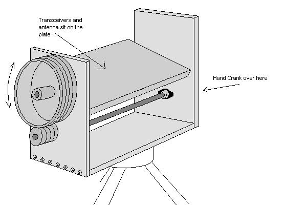

Actually this is for adjusting the elevation angle for microwave and millimeterwave antennas, as well as an optical transceiver. The beamwidth of the antennas is less than 1 degree and for the optical equipment, far less than 1 degree. For the optical setup I'm going to use this elevation control as a rough alignment and then micropositioner motors (with 2 um resolution) for fine adjustments. Each transceiver is about 30 lbs and on will be used at a time.
So basically this thing has to have zero backlash and tight coupling, as well as zero slippage. That for the most part rules out gears and chains, though I suppose zero-backlash gears could be used. Belts would also work I suppose
To get an idea of the size of things, the driven drum will be 6 inches in diameter and the drive capstan, 3/4 inch diameter, both made from 6061 aluminum billet. Initially it will be hand controlled, but eventually I'll add stepper motors so that I can computerize it and automatically track a received signal for best performance.
-Tony

Its sort of for home use. Its more for mountaintop use. Microwaves travel a lot like light so you have to have a clear line-of-sight to the other station to communicate. So two weekends a year there's a contest and everyone goes up to mountaintops to see how far they can talk and to how many people. So it has to withstand soem abuse and still be accurate.
Here's a drawing of what it looks like currently...
