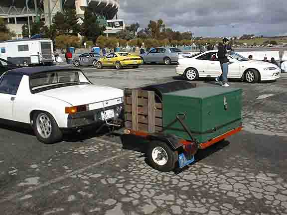

Lawrence took these pics at the MUSR. This would be a nice setup for my AX project. I would like to get a few more details on how / where the hitch was mounted. I assume the plug for the trailer lights just comes out of the trunk? (IMG:style_emoticons/default/confused24.gif)

Pic#2.

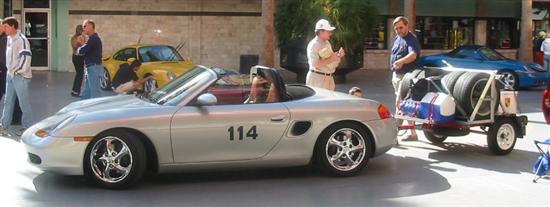

VegasRacer
post Oct 19 2004, 09:50 AM
ELVIRA
Posts: 8,993
Joined: 27-March 03
Member No.: 481
On a boxster.

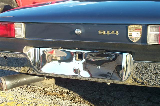

I don't have a reflector on my 914, nor do I want one. (IMG:style_emoticons/default/biggrin.gif) I like the looks of this one behind the plate. I am sure I can fad some sort plate bracket that flips down or up out of the way like other "vintage" cars of the 60's-early 80's did to get to the gas caps.

That car belongs to Murphy, who apparently is pretty active in the PCA or SCCA autocross events in Tulsa - I know that he lives near George Schaffer, who also frequents this board. The mount is the smaller type receiver (1.25"), that has been flipped upside down, and bolted to the trunk floor, directly under the latch.
(Similar to this, only the smaller reciever.)
The receiver goes through the rear wall and is mounted flush with the bumper. Murphy had his trunk covered in custom carpet, and you would never know the receiver was even there if you weren't looking for it. I'm sorry, but I did not take any photos -

Found this picture, I think from a car on ebay but (IMG:style_emoticons/default/barf.gif)

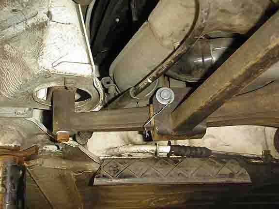

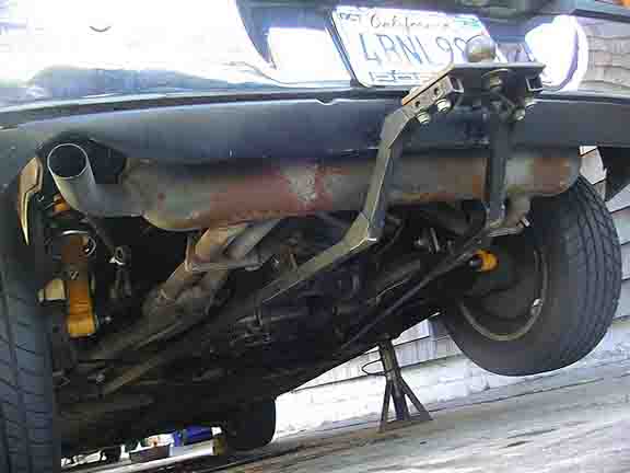

I trailered my tools and race tires to PCA and SCCA events for several years with a small trailer. I didn't want to add any weight to the car, so I built a removable sub-frame that bolted to the engine bar and the tranny mounts. Only two drop links from the tranny mounts had to stay on the car. Mounting and removal took only 2-3 minutes. It wasn't beefy, but worked fine for a small trailer. (I even put a full size side-by-side refrigerator on it once when my truck was out of commission.)
Andrew
AndrewBlyholder
post Oct 19 2004, 02:28 PM
Posts: 112
Joined: 20-September 04
From: Richmond, CA
Member No.: 2,791
trailer sub-frame

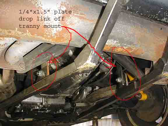

AndrewBlyholder
post Oct 19 2004, 02:29 PM
Posts: 112
From: Richmond, CA
Member No.: 2,791
sub-frame bolted to car
AndrewBlyholder
post Oct 19 2004, 02:31 PM
Posts: 112
From: Richmond, CA
Member No.: 2,791
attachment to engine bar with hitch pin as shear pin. I started out using two bolts in this location, but over time, switched to the single hitch pin as strong enough and much quicker to install/uninstall.

AndrewBlyholder
post Oct 19 2004, 02:35 PM
Posts: 112
From: Richmond, CA
Member No.: 2,791
mounting at tranny
