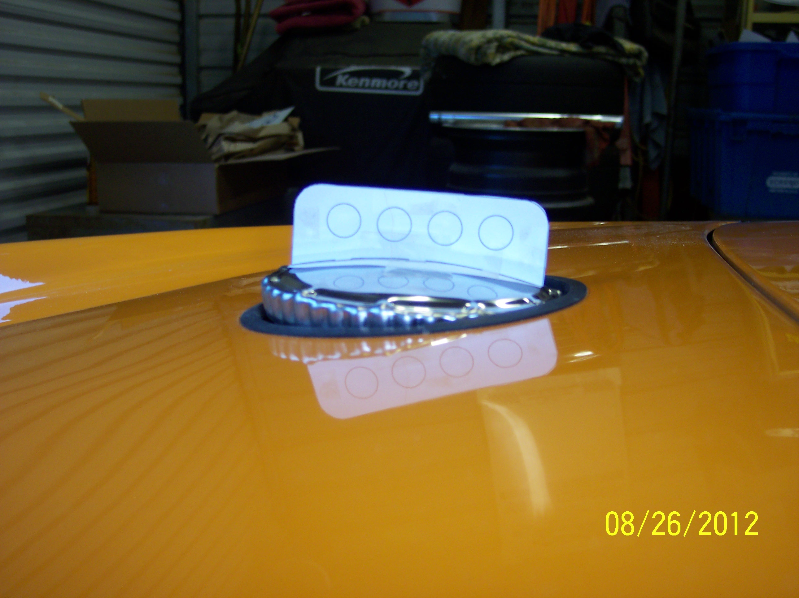

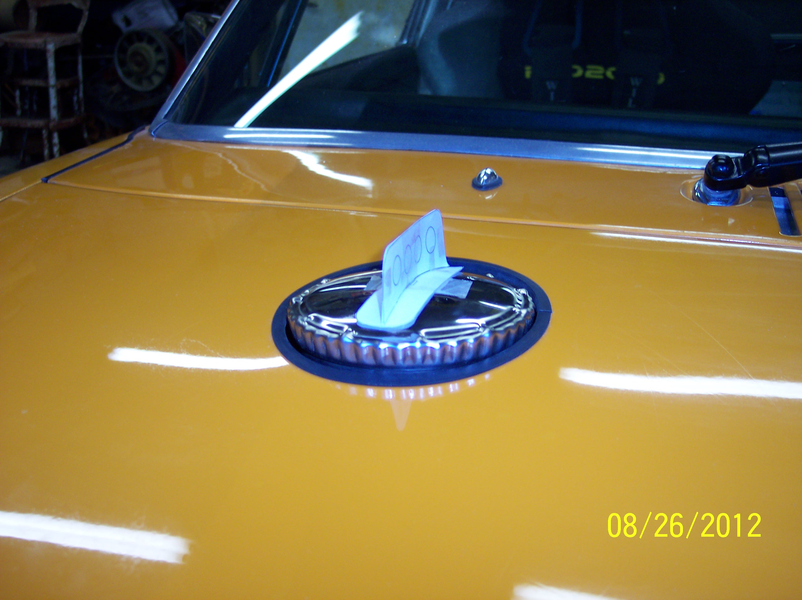

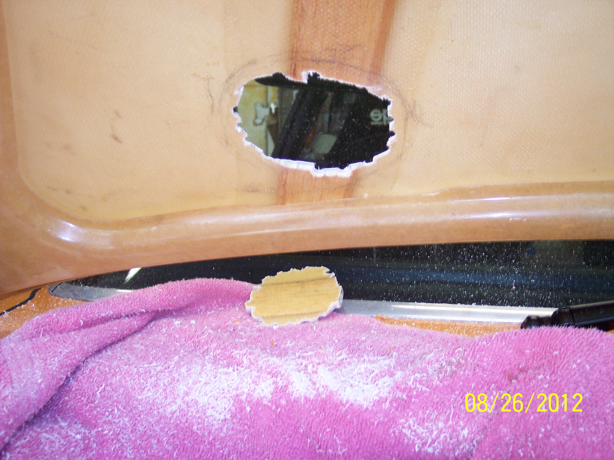

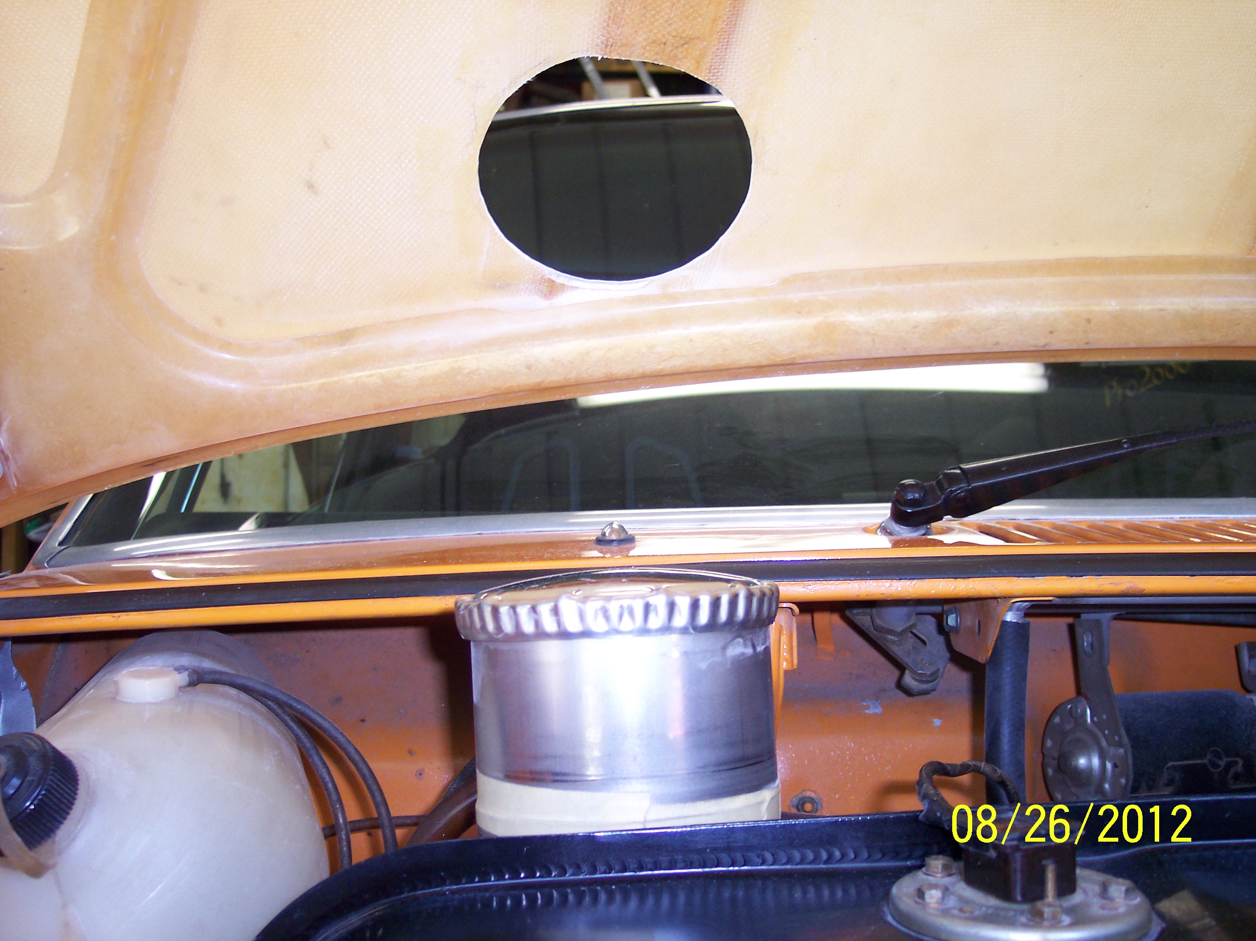

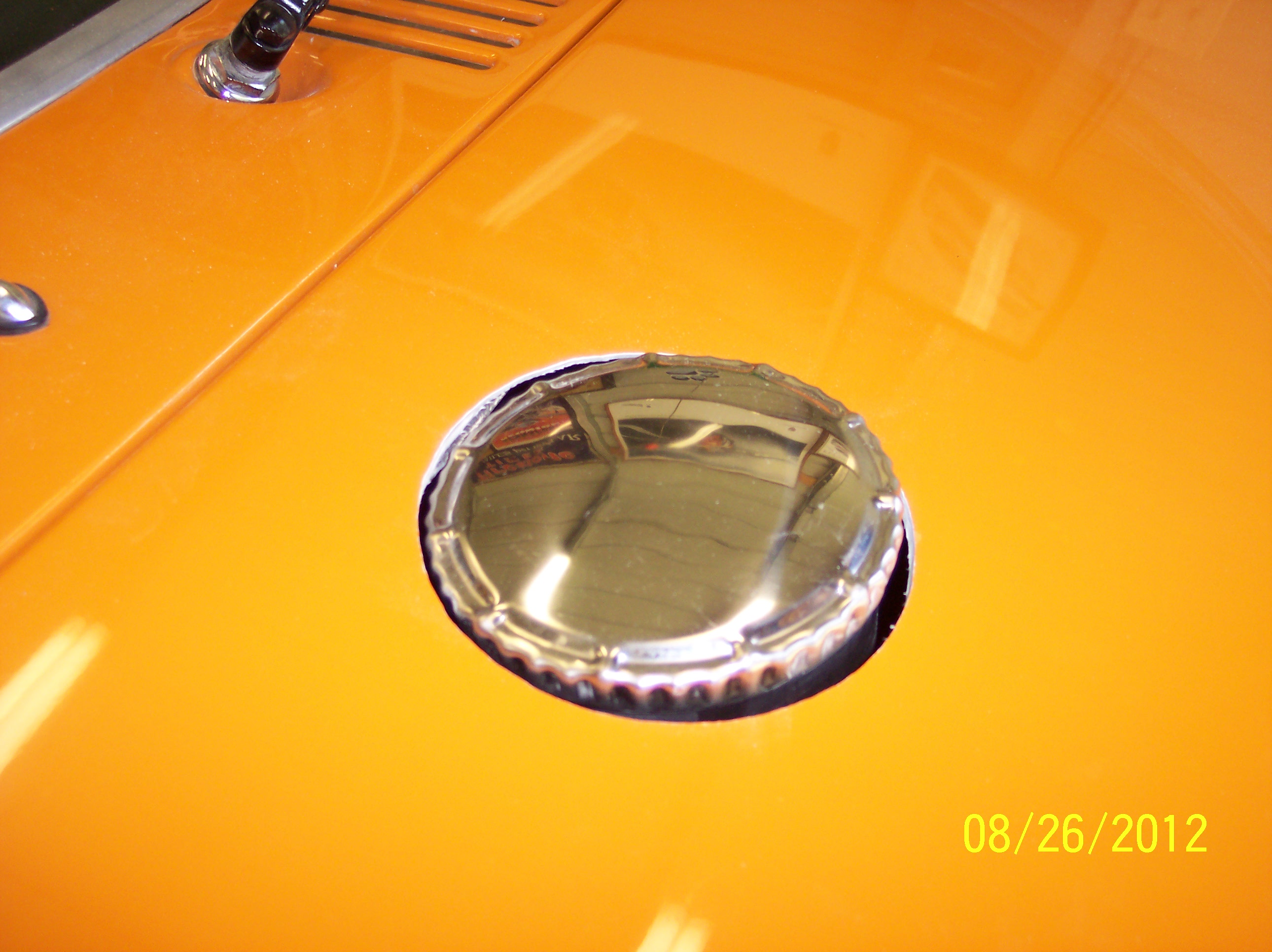

Got some work done on the cap installation. Scary day as it was time to cut the hole in a perfectly good Getty GT type hood. No going back now
I made a 1/2'' spacer to set it up high enough to go through the hood, but not set to high.
I also removed the original cap flanges from the neck, and that allowed for the setting of the new fuel neck.
I found that the neck from a 67-72 Ford F-series pickup will slide right into the 914 neck very snuggly.
Then I went to the auto parts store and got a STANT locking gas cap to fit the new receiver.
It all fits under the 110mm Blau cap with no clearance issues.
The hardest part today was cringing when I took a jigsaw to my Getty GT hood.
Scared to death I'd ruin it, but it turned out okay.
After the initial hole was cut, I printed out a hole template, taped it to the hood, and slowly opened up the with my Dremel. I used the barrel sander attachment to get the hole just right w/out ruining the paint. I finished off the hole with a piece of rubber edging to smooth the look.
Next up is welding up the receiver, and lasering out the bat handle for the cap.
Ron

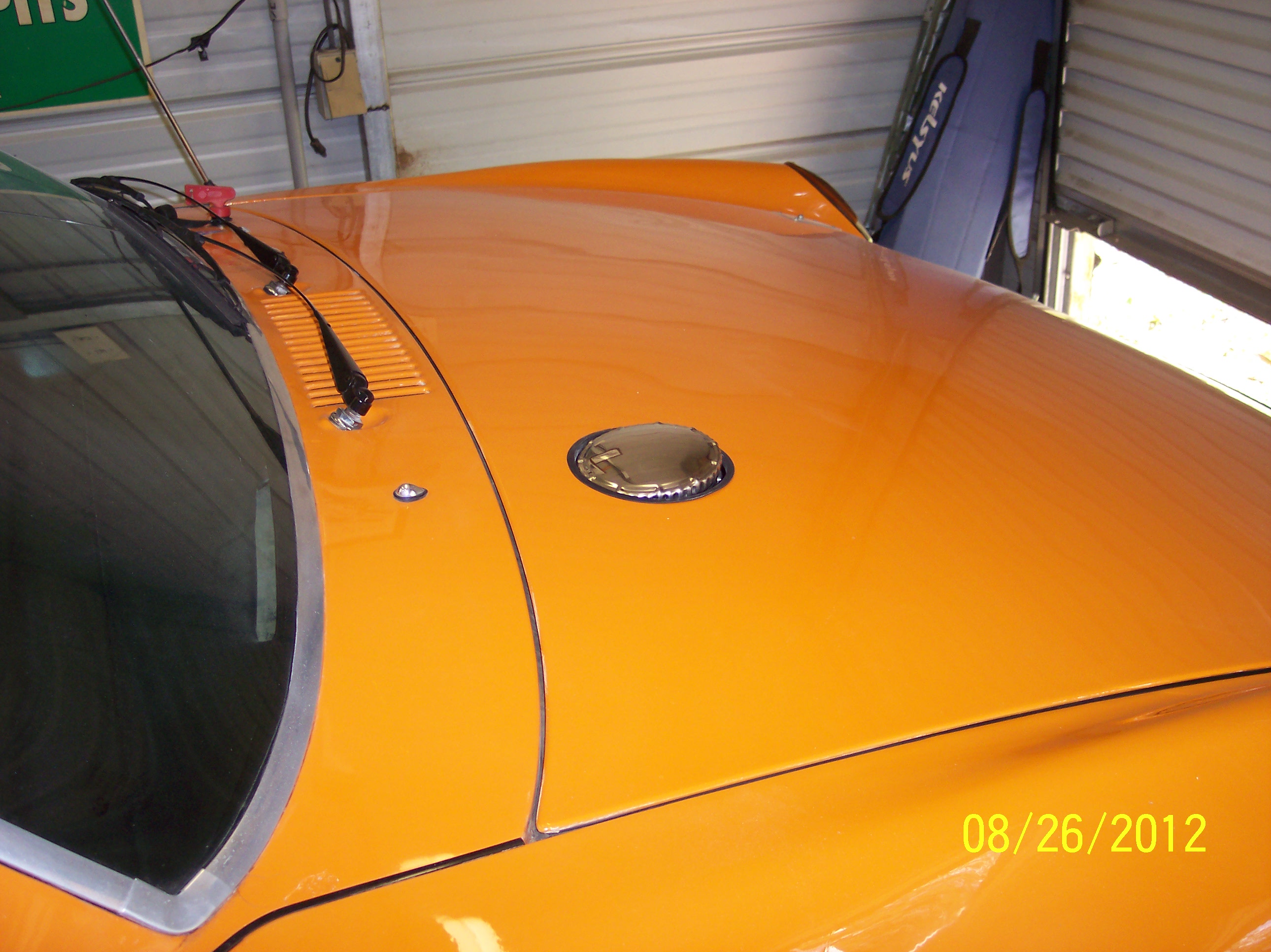

RON S.
post Aug 26 2012, 01:39 PM
9140430841, FINALLY RUNNING
Posts: 1,216
Joined: 22-May 03
From: WALTERBORO,S.C.
Member No.: 724
A few more to complete today's work.
Ron
Attached Image Attached Image Attached Image Attached Image Attached Image Attached Image

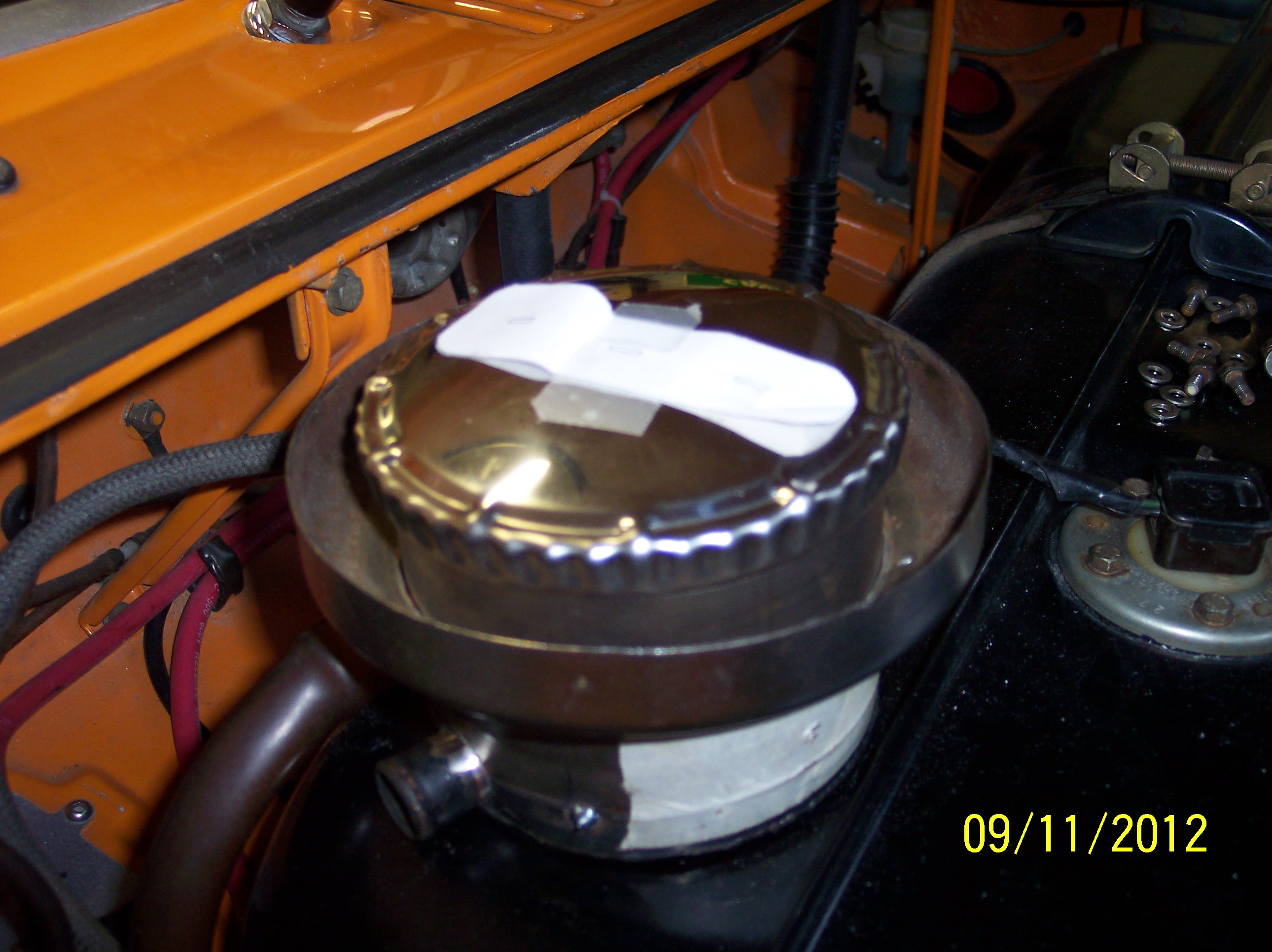

I finally got the parts for the fuel filler neck aligned, fit, and tack welded together for final fitment.
I took a air cleaner cap from a 8hp horizontal Briggs engine and used it to make the rain catch tray that will be welded to he receiver, but sit under the hood.
Another week or to, and the finished filler neck will go off to the powder coater for a shot of semi-gloss black. I also found a stainless steel sink strainer at Lowes for about 4 bucks that I will insert between the filler neck and the gas tank, just to keep crap from falling into the fuel tank due to it now having such a large opening.
Ron (IMG:style_emoticons/default/sawzall-smiley.gif) (IMG:style_emoticons/default/welder.gif) (IMG:style_emoticons/default/smash.gif) (IMG:style_emoticons/default/biggrin.gif)

post Sep 11 2012, 06:09 PM
Posts: 1,216
Joined: 22-May 03
Member No.: 724
Fit up pics of the rain tray...
Next up will be to get the pieces waterjetted for the bat handle that I'll have tig welded to the Blau Cap.
I have made 2 different designs to try out. I with a flat top, and another with a curved top that matches the curve of the top of the Blau cap.
Ron
